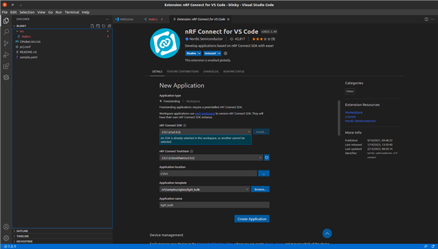

I installed the nRF Connect and installed the Toolchain Manager.
I installed NCS v2.2.0
From the Toolchain manager I started vscode, which was not installed.

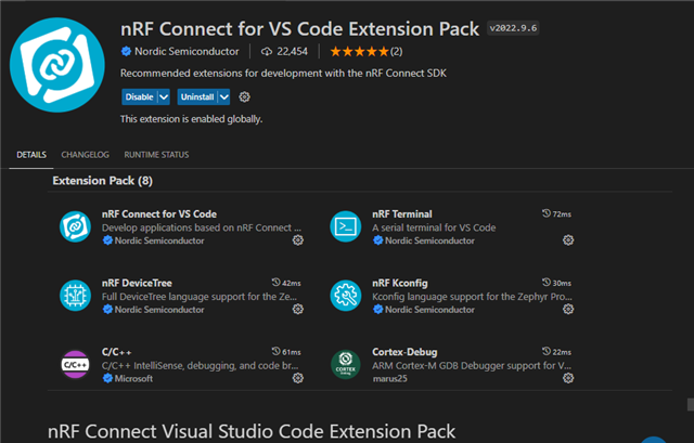

After installing vscode I installed all the plugins.

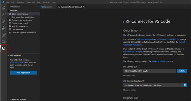

Then the video suggest to go to the nRF welcome page and select the correct toolchain.
But I cannot change the toolchain, instead it's set to version 2.0.2, which is not installed?!
And there is a message saying:
An SDK is already selected in this workspace, so another cannot be selected.
I don't see an option to close the workspace or to create a new workspace.
But in the explorer I do not see a workspace. so I don't understand the error message?
I also tried copying blinky example to a new directory, then choose file - open folder - blinky. But I still cannot change the toolchain.

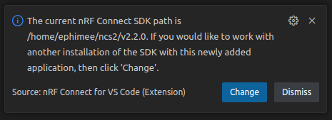

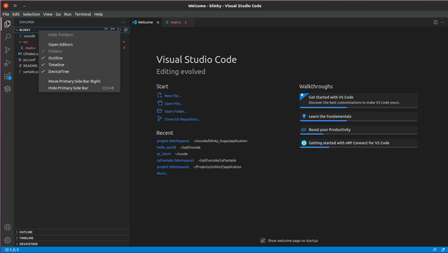

  • I got this popup:
    I pressed dismiss. Then I closed all tabs. Closed vscode. Started vscode from the toolchain manager.
    Then I got a welcome tab. I closed the welcome tab, no tabs remained.

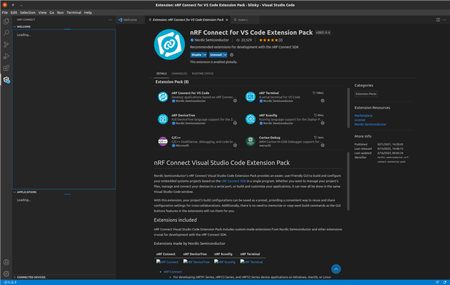

    Then I selected the VS Code Extension Pack. I pressed the nRF Connect button on the left again. But got the same issue with the loading animations (see previous screenshot).

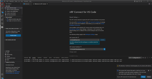

  • This is getting a bit confusing to me. :) I can mention some steps:
    1. Open Toolchain Manager from nRF Connect for Desktop app
    2. Select the Open VS Code option against the required version.
    3. This opens up VSCode. Wait for some time, and then you might get the pop up that you shared regarding changing the SDK version. So then select "Change" and this takes you to the welcome page.
    4. There you can select your required toolchain and SDK version and by this time, hopefully, the "Loading" should have stopped. It happens until all pop ups have been answered usually.
    -Priyanka

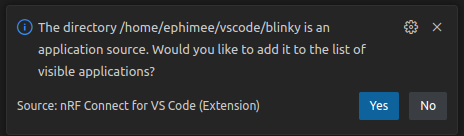

  • Ok, I got the first popup:
    I pressed No.

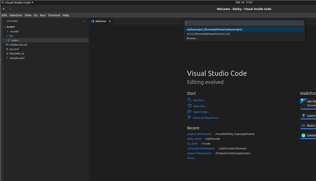

    Then I got the second popup with SDK version and pressed change. But I did not get welcome page, instead I get this:
  • And when you select the v2.2.0, do you still get the loading.... problem ?
  • Most of the time I get loading problems, I tried a few times until I no longer got loading problems.

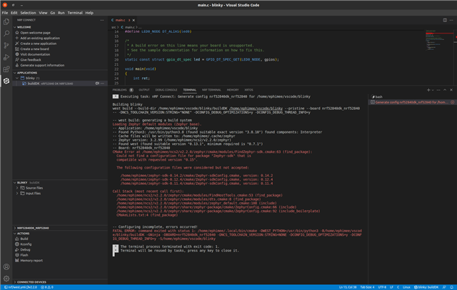

    Then I created build configuration for my Nordic DK and I got the following error message:
    I also attach it as text so it's searchable:
     *  Executing task: nRF Connect: Generate config nrf52840dk_nrf52840 for /home/ephimee/vscode/blinky
    Building blinky
    west build --build-dir /home/ephimee/vscode/blinky/buildDK /home/ephimee/vscode/blinky --pristine --board nrf52840dk_nrf52840 -- -DNCS_TOOLCHAIN_VERSION:STRING="NONE" -DCONFIG_DEBUG_OPTIMIZATIONS=y -DCONFIG_DEBUG_THREAD_INFO=y
    -- Application: /home/ephimee/vscode/blinky
    -- Found Python3: /usr/bin/python3.8 (found suitable exact version "3.8.10") found components: Interpreter
    -- Cache files will be written to: /home/ephimee/.cache/zephyr
    -- Zephyr version: 3.2.99 (/home/ephimee/ncs2/v2.2.0/zephyr)
    -- Found west (found suitable version "0.13.1", minimum required is "0.7.1")
    -- Board: nrf52840dk_nrf52840
    CMake Error at /home/ephimee/ncs2/v2.2.0/zephyr/cmake/modules/FindZephyr-sdk.cmake:63 (find_package):
      Could not find a configuration file for package "Zephyr-sdk" that is
      compatible with requested version "0.15".
      The following configuration files were considered but not accepted:
        /home/ephimee/zephyr-sdk-0.14.2/cmake/Zephyr-sdkConfig.cmake, version: 0.14.2
        /home/ephimee/zephyr-sdk-0.12.4/cmake/Zephyr-sdkConfig.cmake, version: 0.12.4
        /home/ephimee/zephyr-sdk-0.11.4/cmake/Zephyr-sdkConfig.cmake, version: 0.11.4
      /home/ephimee/ncs2/v2.2.0/zephyr/cmake/modules/FindHostTools.cmake:53 (find_package)
      /home/ephimee/ncs2/v2.2.0/zephyr/cmake/modules/dts.cmake:8 (find_package)
      /home/ephimee/ncs2/v2.2.0/zephyr/cmake/modules/zephyr_default.cmake:108 (include)
      /home/ephimee/ncs2/v2.2.0/zephyr/share/zephyr-package/cmake/ZephyrConfig.cmake:66 (include)
      /home/ephimee/ncs2/v2.2.0/zephyr/share/zephyr-package/cmake/ZephyrConfig.cmake:92 (include_boilerplate)
      CMakeLists.txt:4 (find_package)
    FATAL ERROR: command exited with status 1: /home/ephimee/.local/bin/cmake -DWEST_PYTHON=/usr/bin/python3 -B/home/ephimee/vscode/blinky/buildDK -GNinja -DBOARD=nrf52840dk_nrf52840 -DNCS_TOOLCHAIN_VERSION:STRING=NONE -DCONFIG_DEBUG_OPTIMIZATIONS=y -DCONFIG_DEBUG_THREAD_INFO=y -S/home/ephimee/vscode/blinky
    Do I need to install the zephyr SDK manually? It's not part of the installation guide.
