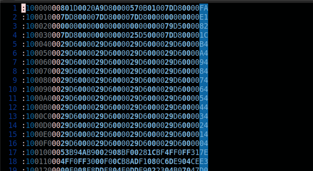

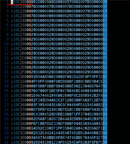

Please find as in below snap the binaries generated from vscode and nCS I am using, There is no padded zeroed header to my build binaries at 0x000000 (Right image below)
While the left image below is the binary i generated with just zephyr and no nCS. It clearly has zero padded header.
So my question is, How can I have zero padded header to binaries generated out of nCS..?
Can i use any config..?
