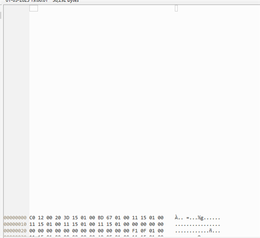

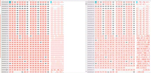

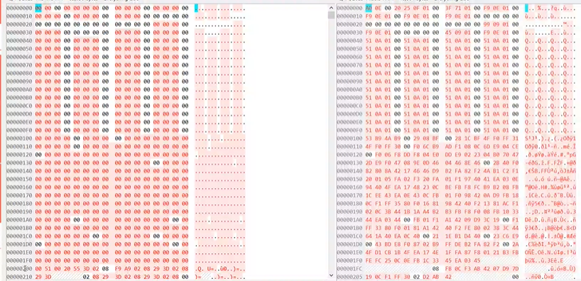

Please find as in below snap the binaries generated from vscode and nCS I am using, There is no padded zeroed header to my build binaries at 0x000000 (Right image below)
While the left image below is the binary i generated with just zephyr and no nCS. It clearly has zero padded header.
So my question is, How can I have zero padded header to binaries generated out of nCS..?

    I will assume the file you refer to is build/zephyr/app_update.bin.
    Our build system automatically generates this file.
    To see the command used to generate this file, you can build using CLI and add "-vvv" to the west command like this:
    west -vvv build -p -b nrf52840dk_nrf52840
    From my code, the generation looks like this:
    [19/24] cd /home/bruk/git/samples_for_nrf_connect_sdk/bootloader_samples/smp/mcuboot_smp_uart/build/modules/mcuboot && /home/bruk/zephyr-sdk-0.15.1/arm-zephyr-eabi/bin/arm-zephyr-eabi-objcopy --input-target=ihex --output-target=binary --gap-fill=0xff /home/bruk/git/samples_for_nrf_connect_sdk/bootloader_samples/smp/mcuboot_smp_uart/build/zephyr/mcuboot_primary_app.hex /home/bruk/git/samples_for_nrf_connect_sdk/bootloader_samples/smp/mcuboot_smp_uart/build/zephyr/app_to_sign.bin && /usr/bin/python3.10 /home/bruk/nrf_connect_sdk/bootloader/mcuboot/scripts/imgtool.py sign --key /home/bruk/nrf_connect_sdk/bootloader/mcuboot/root-ec-p256.pem --header-size 0x200 --align 4 --version 0.0.0+0 --pad-header --slot-size 0x7a000 /home/bruk/git/samples_for_nrf_connect_sdk/bootloader_samples/smp/mcuboot_smp_uart/build/zephyr/app_to_sign.bin /home/bruk/git/samples_for_nrf_connect_sdk/bootloader_samples/smp/mcuboot_smp_uart/build/zephyr/app_update.bin
    As you can see from this, imgtool generates the binary.
    You can try to generate app_update.bin manually from this command and then change arguments to your liking.
    Can you also send the contents of the partition_manager_report? Maybe the padding could be related to the partitions?
    west build -t partition_manager_report
    Sigurd Hellesvik
  • Hello ,
    Thanks for the info.
    The snap of comparision I attached is of zephyr.bin, Sorry I forgot to mention.
    Now If I build simple LED code, on zephyr RTOS+eclipse, I am getting zero prepended "zephyr.bin".
    While for same code if I build on nRF Connect Extension on vscode, I am not getting zero prepended "zephyr.bin".
    So, I need to be able to build zero prepended "zephyr.bin" from nRF Connect Extension on vscode.

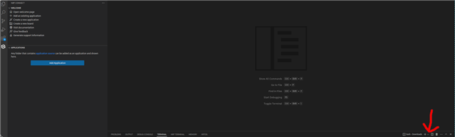

    Also, I have never used CLI build, please help me where I can fire the commands.
    For VS Code, press the arrow beside the "+" sign in the terminal view.
    Then select "nRF Connect SDK". Now you should get a CLI below to type commands.
    Aha, so you want to get the Zero padding.
    Do you build with MCUboot for both projects?
    Do you see the same issue if you build without MCUboot for both projects?
