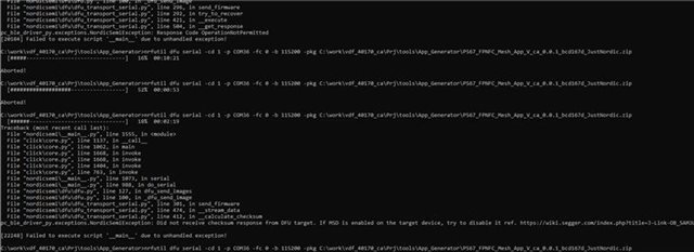

problem with UART update on nRF52840
Good morning,

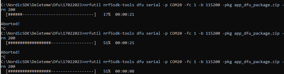

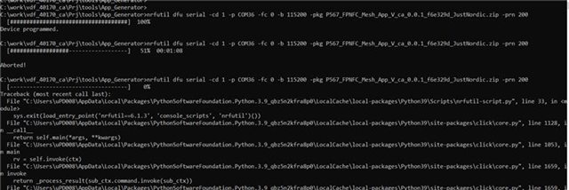

in our project we would like to implement a DFU system of our Nordic 52840 through UART. In the final version of the board the 52840 will be connected to another MCU through serial, but for the moment we are updating the Nordic through a USB serial adapted connected to the rx/tx pins of the Nordic MCU and using the nrfutil.
What we observe is the following:
1) If I upload the fw through nrfutil after having loaded the SD and the BL itself, the procedure is successful in about 25 seconds
2) If I cancel the DFU procedure while it is ongoing and then I repeat it, only the first SLIP packets are exchanged and the first 4k data batch is sent. When the CRC is requested to the Nordic, no answer is apparently received and the program exits. Please see the attached log, obtained with the -v-v-v-v nrfutil option. The command I use is:
nrfutil -v -v -v -v dfu serial -cd 1 -p COM36 -fc 0 -b 115200 -pkg NordicPackage.zip
the used zip has been signed with a proprietary private key (.pem file) and of course the bootloader has been compiled with the related public key. I believe I am safe on the public/private key side cause otherwise the first update would not be successful. We also tried the procedure with the usb-serial option, but the behaviour seems to be the same.
Can you please tell me if you have any idea on what the problem is? I would (naively?) expect that if I interrupt the UART DFU procedure in the middle I should then be able to safely repeat it.
Please find attached:
the sdk_config.h used (it has been changed wrt the original one to adapt it to the project's needs)
the aforementioned log file
Thank you.
Stefano
C:\work\vdf_40170_ca\Prj\tools\App_Generator>nrfutil -v -v -v -v dfu serial -cd 1 -p COM36 -fc 0 -b 115200 -pkg P567_FPNFC_Mesh_App_0_0_0_JustNordic.zip
2023-02-17 09:03:42,181 Using board at serial port: COM36

  File "C:\Users\uPD008\AppData\Local\Packages\PythonSoftwareFoundation.Python.3.9_qbz5n2kfra8p0\LocalCache\local-packages\Python39\Scripts\nrfutil-script.py", line 33, in <module>
    sys.exit(load_entry_point('nrfutil==6.1.3', 'console_scripts', 'nrfutil')())
  File "C:\Users\uPD008\AppData\Local\Packages\PythonSoftwareFoundation.Python.3.9_qbz5n2kfra8p0\LocalCache\local-packages\Python39\site-packages\click\core.py", line 1128, in __call__
    return self.main(*args, **kwargs)
  File "C:\Users\uPD008\AppData\Local\Packages\PythonSoftwareFoundation.Python.3.9_qbz5n2kfra8p0\LocalCache\local-packages\Python39\site-packages\click\core.py", line 1053, in main
    rv = self.invoke(ctx)
  File "C:\Users\uPD008\AppData\Local\Packages\PythonSoftwareFoundation.Python.3.9_qbz5n2kfra8p0\LocalCache\local-packages\Python39\site-packages\click\core.py", line 1659, in invoke
    return _process_result(sub_ctx.command.invoke(sub_ctx))
  File "C:\Users\uPD008\AppData\Local\Packages\PythonSoftwareFoundation.Python.3.9_qbz5n2kfra8p0\LocalCache\local-packages\Python39\site-packages\click\core.py", line 1395, in invoke
    return ctx.invoke(self.callback, **ctx.params)
  File "C:\Users\uPD008\AppData\Local\Packages\PythonSoftwareFoundation.Python.3.9_qbz5n2kfra8p0\LocalCache\local-packages\Python39\site-packages\click\core.py", line 754, in invoke
    return __callback(*args, **kwargs)
  File "C:\Users\uPD008\AppData\Local\Packages\PythonSoftwareFoundation.Python.3.9_qbz5n2kfra8p0\LocalCache\local-packages\Python39\site-packages\nordicsemi\__main__.py", line 1063, in serial
    do_serial(package, port, connect_delay, flow_control, packet_receipt_notification, baud_rate, serial_number, True,
  File "C:\Users\uPD008\AppData\Local\Packages\PythonSoftwareFoundation.Python.3.9_qbz5n2kfra8p0\LocalCache\local-packages\Python39\site-packages\nordicsemi\__main__.py", line 980, in do_serial
    dfu.dfu_send_images()
  File "C:\Users\uPD008\AppData\Local\Packages\PythonSoftwareFoundation.Python.3.9_qbz5n2kfra8p0\LocalCache\local-packages\Python39\site-packages\nordicsemi\dfu\dfu.py", line 127, in dfu_send_images
    self._dfu_send_image(self.manifest.application)
  File "C:\Users\uPD008\AppData\Local\Packages\PythonSoftwareFoundation.Python.3.9_qbz5n2kfra8p0\LocalCache\local-packages\Python39\site-packages\nordicsemi\dfu\dfu.py", line 100, in _dfu_send_image
    self.dfu_transport.send_firmware(data)
  File "C:\Users\uPD008\AppData\Local\Packages\PythonSoftwareFoundation.Python.3.9_qbz5n2kfra8p0\LocalCache\local-packages\Python39\site-packages\nordicsemi\dfu\dfu_transport_serial.py", line 301, in send_firmware
    response['crc'] = self.__stream_data(data=data, crc=response['crc'], offset=i)
  File "C:\Users\uPD008\AppData\Local\Packages\PythonSoftwareFoundation.Python.3.9_qbz5n2kfra8p0\LocalCache\local-packages\Python39\site-packages\nordicsemi\dfu\dfu_transport_serial.py", line 474, in __stream_data
    response = self.__calculate_checksum()
  File "C:\Users\uPD008\AppData\Local\Packages\PythonSoftwareFoundation.Python.3.9_qbz5n2kfra8p0\LocalCache\local-packages\Python39\site-packages\nordicsemi\dfu\dfu_transport_serial.py", line 412, in __calculate_checksum
    raise NordicSemiException('Did not receive checksum response from DFU target. '
pc_ble_driver_py.exceptions.NordicSemiException: Did not receive checksum response from DFU target. If MSD is enabled on the target device, try to disable it ref. https://wiki.segger.com/index.php?title=J-Link-OB_SAM3U

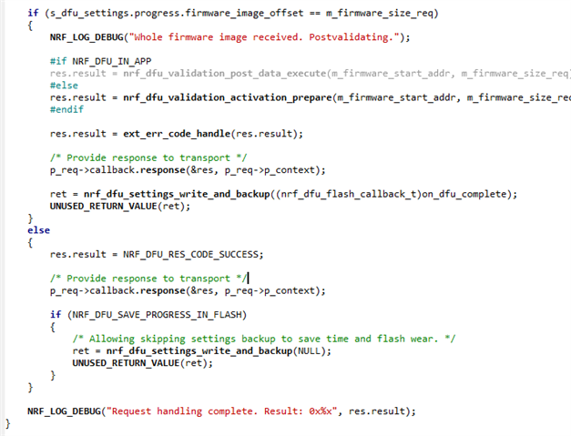

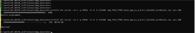

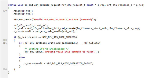

  • Hi Stefano,
    As far as I know nrfutil doesn't have the feature to continue DFU update after interrupted. The documentation here mentioned about that the DFU master can start by select the last object was sent and can determine that it should re-send the object or continue with the new object.
    But this feature is not implemented in nrfutil.
    From the log you provided nrfutil simply send a new init packet (initialize packet ) for a new DFU update. The problem here is that the bootloader is still in the process of the interrupted DFU update. I would assume that it wouldn't expect the init packet and didn't response to the init packet send request.
    So in your case if you are planning to make your own DFU master then you can implement this feature to continue DFU update after interrupted (you can refer to our BLE DFU library on the phone that you can find inside nRF Toolbox or nRF Device Firmware Update. As far as I know the feature to continue after interrupted is implemented on the apps.
    Another option is to send an abort command (0x0C) to reset the bootloader and start a new DFU update. I don't think we have the feature implemented on nrfutil neither. The solution is do a power/pin reset on the board after you have an interrupted DFU update.

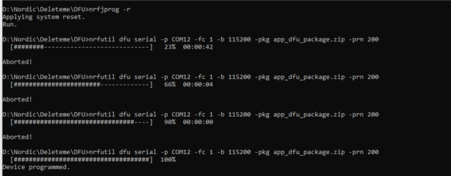

  • Hi Stefano,
    Could you let me know how exactly you did the test ? How you interrupt the DFU process  , by killing nrfutil or by resetting the nRF5 ?
    I did a quick test here and found that the nrfutil actually can continue a DFU update that was interrupted, as long as you turn on the PRN.
    You can see the screen shot here , I break (Ctrl+C) nrfutil at 17% and then it continue from 17% next time I started it. Then I break again at 51% and then next time it will start at 51% and will eventually finish DFU.
    ( I use nrfutil v7.x , it requires extra parameter nrf5sdk-tools to use the "legacy" nrfutil feature)
    If I do a reset of the chip, the next time it will start from 0 and I don't see the issue that the device don't response.
    Have you made sure after you reset the device enter DFU mode? By default you need to hold Button 4 on the DK to make the device enter DFU mode.
  • Dear Hung Bui,
    thank you for your answer and sorry for being late, I was stuck between multiple deadlines...
    In order to do the test I actually interrupted nrfutil with a Ctrl+C, as you do in your example. I am also sure that the device is in DFU mode, as it answers to initial SLIP packets (whose protocol is only implemented in the bootloader, and not in my application). Consider that in my case I do not have flow control, I do not know if it makes any difference.
    I also collected memory readouts of the entire chip which might shed some light on what is going on. The first one shows a readout where a successful (i.e. non-interrupted) update has taken place. The second shows a readout of an interrupted update. By comparing with the first readout one sees that 1k starting from 0x64000 is set to 0xff (my firmware starts at 0x57000, which is probably where the bootloader caches the received data before moving them to the address specified by the linker), most probably the one being transferred when I hit ctrl+c. One can also see that some bits in the end are also different, probably those related to the CRC. The third readout refers to an update attempt after the interruption has taken place. One sees that, with respect to the second readout, the initial 1k (i.e. the one starting at 0x57000) is set to 0xff, which means that the first block was erased by the update process but the update could not proceed. From my log I can see indeed that the first 1k was transferred (see slip_log.txt), but the CRC requested after it was never received.
    I believe that the interrupted fw update triggers somehow a wrong CRC when a subsequent update attempt is performed, but I cannot clearly see how to cure it. Do you have more insight on the issue?
    Thanks.
    Stefano
    PS: the "Nordic" txt files are originally .mot files which I renamed. For some reason Nordic page does not allow to upload .mot files
    Stefano

  • Hi Stefano,
    Did you do any modification to the bootloader ?
    Why you application starts at 0x57000 ? Is there any reason for that? It's not a familiar start address to me. How did you configure the bootloader to jump to this address ?
    How large is your application ? I would assume the size of the application should be around 0x64000 - 0x57000 = 52 kB ?
    I assume it's dual bank DFU you are doing.
    Normally the bootloader would receive the new image to the secondary bank (slot 1, the application is in primary bank-slot 0). Only after the image is received properly it will start erasing the original application and swapping the new image to the primary bank. So it's very strange that 0x57000 being erase even before the DFU update process is finished.
    Which software did you use to get the flash dump out ? I just want to double check if the address is correct.
