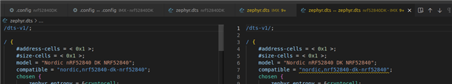

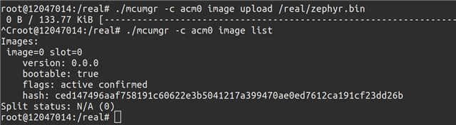

    Sorry for the late response as I've faced a delay in receiving the custom board for checking.
    While the UART serial recovery method you mentioned works flawlessly on the nrf52840dk board, I have not had the same success with my custom board using the wait method to enter recovery on each boot. Fortunately, this discussion has provided me with some useful insights.
     MCUBoot usb with openthread sample
    Could you guide me on where to make the changes referred to in that thread that supposedly worked? I couldn't locate the file.

    For custom boards, you must also set the clock config in MCUboot. Child images do not inherit this configuration from the board file, so you must explicitly set it in the child image's configuration. You can set this in child_image/mcuboot.conf.
