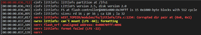

  • I'm getting this error now when I set CONFIG_PM_PARTITION_SIZE_LITTLEFS to any value bigger than 0xf000:
    do you know what could it be?
  • even when the value is 0x7000, it still gives this error:
    Could you provide the memory layout for the partition, partitions.yml under build folder, overlay, and config files? If you are using pm_static.yml, please also share it.
    -Amanda H.
