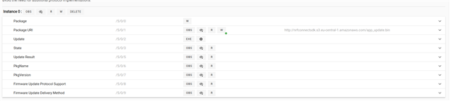

Good day
I have recently updated my toolchain and now I seem to be have having trouble with FOTA updates over lwm2m using the lwm2m client and over NBIOT.  I am following the instructions and help stated in this link https://developer.nordicsemi.com/nRF_Connect_SDK/doc/2.2.0/nrf/ug_nrf91_features.html#nrf9160-fota  .  Please assist if possible.

The error i get is
Obtained date-time from modem[0m[1;32muart:~$ [m[8D[J[1;32muart:~$ [m[8D[J[00:00:58.221,557]
[0m<inf> lwm2m_firmware: Image type 1 [0m[1;32muart:~$ [m[8D[J[00:00:58.226,379]
[0m<inf> lwm2m_firmware: Application firmware download started.[0m[1;32muart:~$ [m[8D[J[1;32muart:~$ [m[8D[J[00:00:59.594,360]
[1;31m<err> net_lwm2m_message_handling: Cannot find block context[0m[1;32muart:~$ [m[8D[J[1;32muart:~$ [m[8D[J[00:02:08.828,063]
  • Hi
    Could you share your full log?
    It looks like that error is thrown after the application image has been downloaded, is that correct?
    From which ncs version did you upgrade from? Have you tried to replicate this issue in the stock lwm2m_client sample?
    Håkon
  • Hi Håkon
    I am currently using v3.2.99-ncs2-rc1.  The error is  thrown before the download takes place.

  • Can you share how you push the update?
    Do you write to the "Package URI"?
    Here's the URI that I write (http) and this is pushed to the device.
    Here's the log:

    [00:01:54.074,493] <inf> download_client: Downloaded 75776/157806 bytes (48%)
    [00:01:54.242,706] <inf> download_client: Downloaded 76800/157806 bytes (48%)
    [00:01:54.394,500] <inf> download_client: Downloaded 77824/157806 bytes (49%)
    [00:01:54.554,534] <inf> download_client: Downloaded 78848/157806 bytes (49%)
    [00:01:54.794,525] <inf> download_client: Downloaded 79872/157806 bytes (50%)
    [00:01:54.954,528] <inf> download_client: Downloaded 80896/157806 bytes (51%)
    [00:01:55.114,562] <inf> download_client: Downloaded 81920/157806 bytes (51%)
    [00:01:55.275,543] <inf> download_client: Downloaded 82944/157806 bytes (52%)
    [00:01:55.514,556] <inf> download_client: Downloaded 83968/157806 bytes (53%)
    [00:01:55.682,678] <inf> download_client: Downloaded 84992/157806 bytes (53%)
    [00:01:55.843,688] <inf> download_client: Downloaded 86016/157806 bytes (54%)
    [00:01:56.012,725] <inf> download_client: Downloaded 87040/157806 bytes (55%)
    [00:01:56.324,615] <inf> download_client: Downloaded 88064/157806 bytes (55%)
    [00:01:56.498,657] <inf> download_client: Downloaded 89088/157806 bytes (56%)
    [00:01:56.634,643] <inf> download_client: Downloaded 90112/157806 bytes (57%)
    [00:01:56.802,734] <inf> download_client: Downloaded 91136/157806 bytes (57%)
    [00:01:57.052,764] <inf> download_client: Downloaded 92160/157806 bytes (58%)
    [00:01:57.202,941] <inf> download_client: Downloaded 93184/157806 bytes (59%)
    [00:01:57.362,823] <inf> download_client: Downloaded 94208/157806 bytes (59%)
    [00:01:57.519,683] <inf> download_client: Downloaded 95232/157806 bytes (60%)
    [00:01:57.759,704] <inf> download_client: Downloaded 96256/157806 bytes (60%)
    [00:01:57.921,813] <inf> download_client: Downloaded 97280/157806 bytes (61%)
    [00:01:58.082,855] <inf> download_client: Downloaded 98304/157806 bytes (62%)
    [00:01:58.242,889] <inf> download_client: Downloaded 99328/157806 bytes (62%)
    [00:01:58.487,823] <inf> download_client: Downloaded 100352/157806 bytes (63%)
    [00:01:58.642,883] <inf> download_client: Downloaded 101376/157806 bytes (64%)
    [00:01:58.764,282] <wrn> download_client: Peer closed connection, will re-connect
    [00:01:58.804,016] <inf> download_client: Downloaded 102400/157806 bytes (64%)
    [00:01:58.815,460] <inf> download_client: Reconnecting..
    [00:01:58.877,349] <inf> download_client: Connecting to http://nrfconnectsdk.s3.eu-central-1.amazonaws.com
    [00:01:59.130,828] <inf> download_client: Downloaded 103424/157806 bytes (65%)
    [00:01:59.361,907] <inf> download_client: Downloaded 104448/157806 bytes (66%)
    [00:01:59.528,869] <inf> download_client: Downloaded 105472/157806 bytes (66%)
    [00:01:59.674,774] <inf> download_client: Downloaded 106496/157806 bytes (67%)
    [00:01:59.834,777] <inf> download_client: Downloaded 107520/157806 bytes (68%)
    [00:02:00.074,798] <inf> download_client: Downloaded 108544/157806 bytes (68%)
    [00:02:00.243,896] <inf> download_client: Downloaded 109568/157806 bytes (69%)
    [00:02:00.394,805] <inf> download_client: Downloaded 110592/157806 bytes (70%)
    [00:02:00.554,901] <inf> download_client: Downloaded 111616/157806 bytes (70%)
    [00:02:00.812,927] <inf> download_client: Downloaded 112640/157806 bytes (71%)
    [00:02:00.953,948] <inf> download_client: Downloaded 113664/157806 bytes (72%)
    [00:02:01.114,837] <inf> download_client: Downloaded 114688/157806 bytes (72%)
    [00:02:01.274,841] <inf> download_client: Downloaded 115712/157806 bytes (73%)
    [00:02:01.522,949] <inf> download_client: Downloaded 116736/157806 bytes (73%)
    [00:02:01.673,980] <inf> download_client: Downloaded 117760/157806 bytes (74%)
    [00:02:01.834,960] <inf> download_client: Downloaded 118784/157806 bytes (75%)
    [00:02:02.002,990] <inf> download_client: Downloaded 119808/157806 bytes (75%)
    [00:02:02.234,893] <inf> download_client: Downloaded 120832/157806 bytes (76%)
    [00:02:02.394,012] <inf> download_client: Downloaded 121856/157806 bytes (77%)
    [00:02:02.554,931] <inf> download_client: Downloaded 122880/157806 bytes (77%)
    [00:02:02.714,965] <inf> download_client: Downloaded 123904/157806 bytes (78%)
    [00:02:02.964,050] <inf> download_client: Downloaded 124928/157806 bytes (79%)
    [00:02:03.124,053] <inf> download_client: Downloaded 125952/157806 bytes (79%)
    [00:02:03.274,963] <inf> download_client: Downloaded 126976/157806 bytes (80%)
    [00:02:03.434,967] <inf> download_client: Downloaded 128000/157806 bytes (81%)
    [00:02:03.674,957] <inf> download_client: Downloaded 129024/157806 bytes (81%)
    [00:02:03.871,093] <inf> download_client: Downloaded 130048/157806 bytes (82%)
    [00:02:04.074,981] <inf> download_client: Downloaded 131072/157806 bytes (83%)
    [00:02:04.234,985] <inf> download_client: Downloaded 132096/157806 bytes (83%)
    [00:02:04.532,165] <inf> download_client: Downloaded 133120/157806 bytes (84%)
    [00:02:04.714,111] <inf> download_client: Downloaded 134144/157806 bytes (85%)
    [00:02:04.875,030] <inf> download_client: Downloaded 135168/157806 bytes (85%)
    [00:02:05.034,149] <inf> download_client: Downloaded 136192/157806 bytes (86%)
    [00:02:05.274,169] <inf> download_client: Downloaded 137216/157806 bytes (86%)
    [00:02:05.443,145] <inf> download_client: Downloaded 138240/157806 bytes (87%)
    [00:02:05.595,062] <inf> download_client: Downloaded 139264/157806 bytes (88%)
    [00:02:05.810,119] <inf> download_client: Downloaded 140288/157806 bytes (88%)
    [00:02:06.075,103] <inf> download_client: Downloaded 141312/157806 bytes (89%)
    [00:02:06.245,178] <inf> download_client: Downloaded 142336/157806 bytes (90%)
    [00:02:06.433,227] <inf> download_client: Downloaded 143360/157806 bytes (90%)
    [00:02:06.652,191] <inf> download_client: Downloaded 144384/157806 bytes (91%)
    [00:02:06.893,188] <inf> download_client: Downloaded 145408/157806 bytes (92%)
    [00:02:07.098,266] <inf> download_client: Downloaded 146432/157806 bytes (92%)
    [00:02:07.293,151] <inf> download_client: Downloaded 147456/157806 bytes (93%)
    [00:02:07.453,155] <inf> download_client: Downloaded 148480/157806 bytes (94%)
    [00:02:07.770,172] <inf> download_client: Downloaded 149504/157806 bytes (94%)
    [00:02:07.931,243] <inf> download_client: Downloaded 150528/157806 bytes (95%)
    [00:02:08.084,320] <inf> download_client: Downloaded 151552/157806 bytes (96%)
    [00:02:08.243,347] <inf> download_client: Downloaded 152576/157806 bytes (96%)
    [00:02:08.476,318] <inf> download_client: Downloaded 153600/157806 bytes (97%)
    [00:02:08.646,331] <inf> download_client: Downloaded 154624/157806 bytes (97%)
    [00:02:08.805,206] <inf> download_client: Downloaded 155648/157806 bytes (98%)
    [00:02:08.898,071] <dbg> app_lwm2m_client: rd_client_event: Queue mode RX window closed
    [00:02:08.954,345] <inf> download_client: Downloaded 156672/157806 bytes (99%)
    [00:02:09.195,251] <inf> download_client: Downloaded 157696/157806 bytes (99%)
    [00:02:09.332,427] <inf> download_client: Downloaded 157806/157806 bytes (100%)
    [00:02:09.332,458] <inf> download_client: Download complete
    [00:02:09.420,654] <inf> dfu_target_mcuboot: MCUBoot image-0 upgrade scheduled. Reset device to apply
    [00:02:09.421,142] <inf> lwm2m_firmware: FOTA download finished
    Håkon
  • Hi Håkon
    I write to the package and not the package URI.  I use the "\build\zephyr\app_update.bin" file saved within my project.  This is where I get the "cannot find block context" error.
    Hassan
  • Hi Hassan,
    I wasn't able to use the "package" properly, but I did find this in the leshan wiki:
    https://github.com/eclipse/leshan/wiki/Using-CoAP-Block-Wise-to-transfer-large-file-%3F
    I would recommend that you try to push an URI instead.
    Håkon
