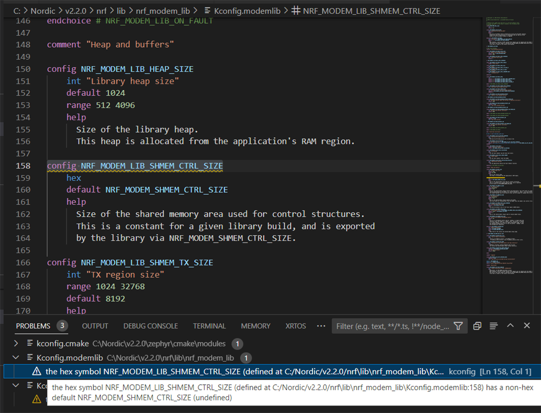

Warning 1:
"the hex symbol NRF_MODEM_LIB_SHMEM_CTRL_SIZE (defined at C:/Nordic/v2.2.0/nrf\lib\nrf_modem_lib\Kconfig.modemlib:158) has a non-hex default NRF_MODEM_SHMEM_CTRL_SIZE (undefined)" in "Kconfig.modemlib"

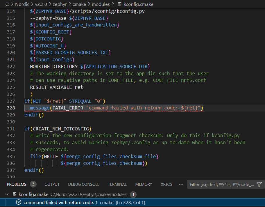

 *  Executing task: nRF Connect: Generate config nrf52dk_nrf52832 for c:\Nordic\myApp\HelloWorld
Building HelloWorld

warning: the hex symbol NRF_MODEM_LIB_SHMEM_CTRL_SIZE (defined at C:/Nordic/v2.2.0/nrf\lib\nrf_modem_lib\Kconfig.modemlib:158) has a non-hex default NRF_MODEM_SHMEM_CTRL_SIZE (undefined)

error: Aborting due to Kconfig warnings
Parsing C:/Nordic/v2.2.0/zephyr/Kconfig
Loaded configuration 'C:/Nordic/v2.2.0/zephyr/boards/arm/nrf52dk_nrf52832/nrf52dk_nrf52832_defconfig'

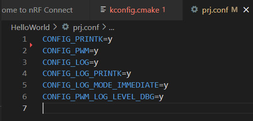

Merged configuration 'C:/Nordic/myApp/HelloWorld/prj.conf'
Merged configuration 'C:/Nordic/myApp/HelloWorld/build/zephyr/misc/generated/extra_kconfig_options.conf'
CMake Error at C:/Nordic/v2.2.0/zephyr/cmake/modules/kconfig.cmake:328 (message):
  C:/Nordic/v2.2.0/nrf/cmake/modules/kconfig.cmake:29 (include)
  C:/Nordic/v2.2.0/zephyr/cmake/modules/zephyr_default.cmake:108 (include)
  C:/Nordic/v2.2.0/zephyr/share/zephyr-package/cmake/ZephyrConfig.cmake:66 (include)
  C:/Nordic/v2.2.0/zephyr/share/zephyr-package/cmake/ZephyrConfig.cmake:92 (include_boilerplate)
  CMakeLists.txt:4 (find_package)
FATAL ERROR: command exited with status 1: 'c:\Nordic\toolchains\v2.2.0\opt\bin\cmake.EXE' '-DWEST_PYTHON=c:\Nordic\toolchains\v2.2.0\opt\bin\python.exe' '-Bc:\Nordic\myApp\HelloWorld\build' -GNinja -DBOARD=nrf52dk_nrf52832 -DNCS_TOOLCHAIN_VERSION:STRING=NONE -DCONFIG_DEBUG_OPTIMIZATIONS=y -DCONFIG_DEBUG_THREAD_INFO=y -DBOARD_ROOT:STRING=c:/Nordic/myApp/HelloWorld '-Sc:\Nordic\myApp\HelloWorld'
