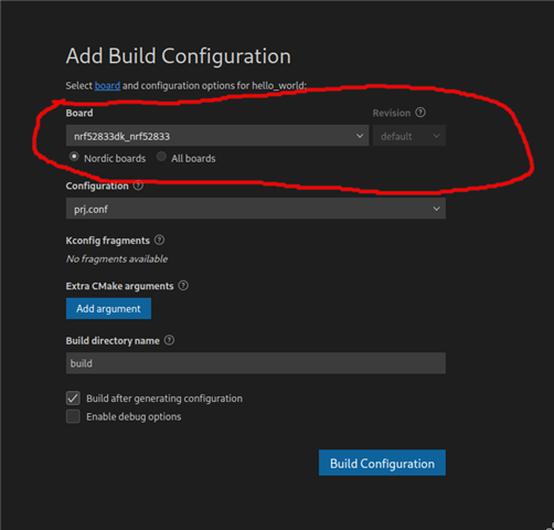

    For my Question:
    Sigurd Hellesvik said:
    Which zephyr "board name" are you building for?
    I am asking "how you build your project?"
