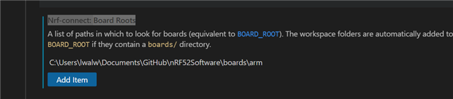

I've set my Board Roots variable:

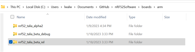

The folder specified is root to my board definitions:

Could you try making the board root point to /Users/lwalw/Documents/GitHub/nRF52Software instead? I believe the board root needs a board folder, which /boards/arm/ doesn't.
Elfving
yes, that fixed it. thanks.
