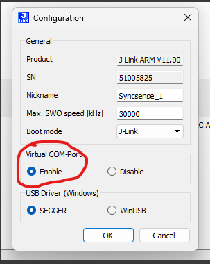

nRFConnect for Desktop 4.0.0, Programmer 3.0.7 incompatable my Jlinks (I have two), Tried multiple things to fix issue
I have tried fixing this issue for a few hours to no avail.
Here are the error messages I am getting:

This is the error message I am getting now when I was trying to match the JLINK version with the 'provided one' whatever that means, My Jlink is recognised but only because I have enabled Virtual com ports in Jlink config:
