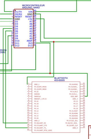

Brand new beginner to nrf and Nordic hardware, I'm trying to build a simple bluetooth application for a BL651 module (nrf52810 chip), and I'm not really sure on how to proceed so far.

Idea is to send/receive bluetooth messaged through the module via Arduino/Uart as followed:
