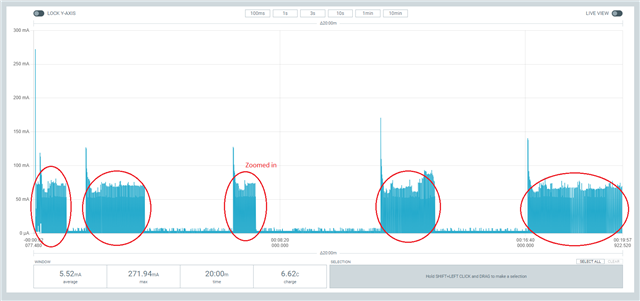

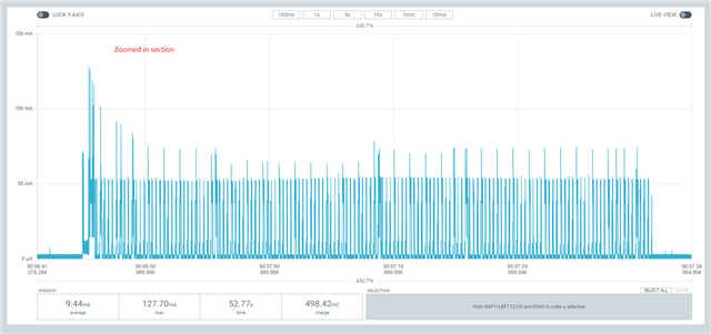

Dir Sir/Madam,
I let the UDP example run for 20 minutes.
I changed the example to make a second connection after 90 seconds and then every 5 minutes.
Every time it connects it sends 38 bytes of data.
Why is the acivity duration / power consumption so different each time the device connects?
Is the RRC inactivity timer not constant?
Does it depent on the SIM/network provider?
[2023-03-03 17:18:23.667] I: Trace thread ready
[2023-03-03 17:18:23.677] I: Trace level override: 2
[2023-03-03 17:18:23.678] *** Booting Zephyr OS build v3.2.99-ncs1 ***
[2023-03-03 17:18:23.682] UDP sample has started
[2023-03-03 17:18:32.906] LTE cell changed: Cell ID: 1175162, Tracking area: 563
[2023-03-03 17:18:32.948] RRC mode: Connected
[2023-03-03 17:18:35.824] Network registration status: Connected - roaming
[2023-03-03 17:18:35.828]
[2023-03-03 17:18:35.829] PSM parameter update: TAU: 3600, Active time: 0
[2023-03-03 17:18:35.834] Transmitting UDP/IP payload of 38 bytes to the IP address 8.8.8.8, port number 2469
[2023-03-03 17:19:26.304] RRC mode: Idle
[2023-03-03 17:19:26.306]
[2023-03-03 17:20:05.841] Transmitting UDP/IP payload of 38 bytes to the IP address 8.8.8.8, port number 2469
[2023-03-03 17:20:06.418] RRC mode: Connected
[2023-03-03 17:22:05.753] RRC mode: Idle
[2023-03-03 17:22:05.755]
[2023-03-03 17:25:05.848] Transmitting UDP/IP payload of 38 bytes to the IP address 8.8.8.8, port number 2469
[2023-03-03 17:25:06.420] RRC mode: Connected
[2023-03-03 17:25:51.800] RRC mode: Idle
[2023-03-03 17:25:51.803]
[2023-03-03 17:30:05.857] Transmitting UDP/IP payload of 38 bytes to the IP address 8.8.8.8, port number 2469
[2023-03-03 17:30:06.429] RRC mode: Connected
[2023-03-03 17:31:57.018] RRC mode: Idle
[2023-03-03 17:31:57.019]
[2023-03-03 17:35:05.866] Transmitting UDP/IP payload of 38 bytes to the IP address 8.8.8.8, port number 2469
[2023-03-03 17:35:06.438] RRC mode: Connected
[2023-03-03 17:38:55.939] RRC mode: Idle
[2023-03-03 17:38:55.940]
trace-2023-03-03T16-18-16.890Z.bin
trace-2023-03-03T16-18-16.890Z.pcapng
modified udp example.zip
Development setup:
nRF9160DK PCA10090 1.1.0
Power profiler II pca61100 1.0.1
Modem firmware: mfw_nrf9160_1.3.4.zip
NRF Connect SDK V2.2.0
Telenor SIM card (roaming)
Windows 11
With best regards,
Willem
Parents Reply
  • > We will swap to another provider
    Just take care. If it's a "global SIM" 9xxxx and you use mfw 1.3.2 or newer, there is a pitfall with HPPLMN searchs (that depends also on the HPPLMN search interval on the SIM). With such a SIM you will be faced a couple of searches for a 9xxxx network, even if your just in a common country. In my case that caused 1800mC every 2h (2h is the search interval on my previous SIM cards).
    Good luck. It's not easy to find SIM cards, which are really fits low power use-cases.
