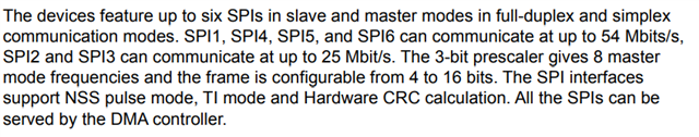

SPI communication between STM32F7ZI and NRF52833DK
I need to set up communication between STM32FZI (Acting as Master) and NRF52833DK (Acting as Slave). But when I use the spis slave example in the NRF5 SDK, the communication is established but the data received is not the correct size. I am sending the message "SPI" from the STM32 but on the receiving end sometimes "SPIS", "PIS", and "P" is seen. I have checked using the oscilloscope and the data sent on the MOSI line is correct and the bytes represent "SPI". When and how does the spis_event_handler get called exactly? Since there is only one function (namely nrf_drv_spis_buffers_set) to execute the transfer while multiple are present in STM32F7 API, how does the DMA function?

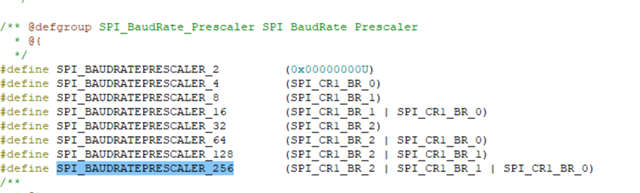

  SpiHandle.Init.BaudRatePrescaler = SPI_BAUDRATEPRESCALER_256;

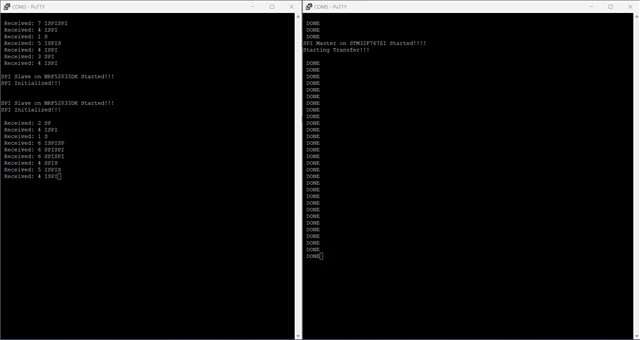

COM3 - NRF52833 , COM5 - STM32f7
