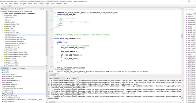

  • Hi Nick,
    Which chip are you working with ?
    I'm not so sure why you are testing with PCA10040e if you have nRF52832.
    I compiled the bootloader project here and saw no issue compiling.
    NRF_GPIO_PIN_SENSE_LOW is defined in nrf_gpio.h . Could you please double check ?  I would suggest to try testing on a fresh copy of nRF5 SDK.
    Could you show how you generate .zip file. And also show us the size of the application (either when compiling or show us the .bin file).

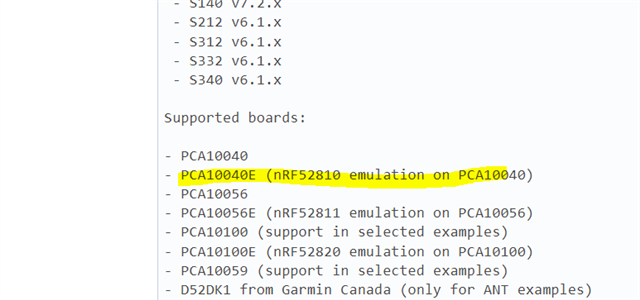

  • Hi Nick,
    Nick_RA said:
    The only reason I'm using PCA10040e example is because that is the nearest as far as I can see that would fit.
    I don't think it's a good idea. PCA10040e example is for emulating the nRF52810 on a nRF52832. This may explain why you receive  insufficient resource error. The nRF52810 has only 192kB of flash.
    Please have a look here: https://infocenter.nordicsemi.com/topic/sdk_nrf5_v17.1.0/index.html?cp=9_1_0

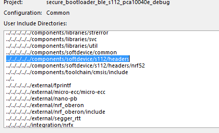

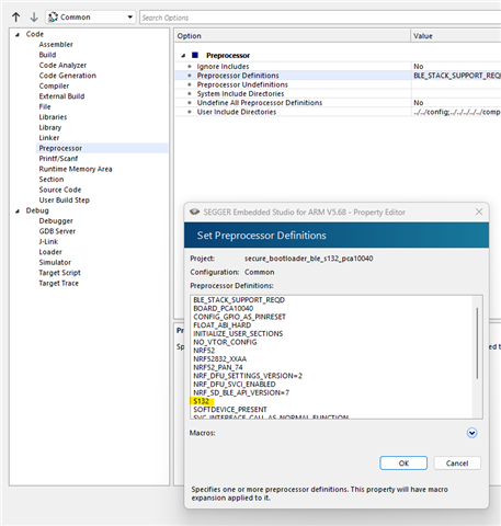

    If you want to use S112 with nRF52832 you should base on S132 example and then need to change the :
    - Preprocessor symbol to S112
    - Start address of your application
    - Change the include directory of header file for S132 softdevice to S112 softdevice:

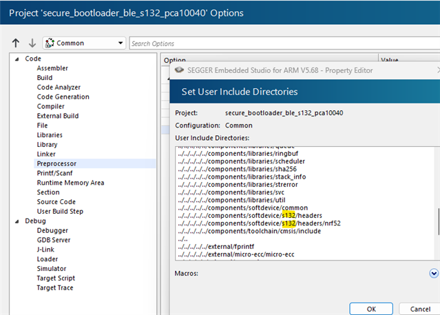

  • Thanks for your patience, and sorry if I'm appearing a bit obtuse :/
    Firstly, I've downloaded a fresh example and using "pca10040_s132_ble" (Segger) is giving the buttons not defined error when building when compiled as-is making no changes apart from replacing the dummy public key file. It's not an issue for me as I'm not using buttons anyway and it builds fine with the buttonless option removed.
    On final (hopefully!) thing I don't really get is the memory addresses. Obviously one needs to set the addresses for the bootloader program itself to load & run, but I assume the bootloader needs to know the main application start address, which I can't see?
    FYI, here's the Segger project file contents, this is the s132 bootloader being tweaked to s112

  • Hi Nick,
    It's strange that the bootloader didn't work out of the box. It's been there for a few years and we haven't got any report about this. Maybe you can test on a fresh copy of the SDK.
    Regarding your question, the bootloader automatically know the start address of the application because it has to be located right after the softdevice. The bootloader just need to read a special register in the softdevice to know the size of the softdevice. So you don't have to change that in the bootloader.
    However, if you change the softdevice in the application, you need to change the start address of the application according to the size of the softdevice. You can find the size of the softdevice by looking at the release note or look at an example that use the softdevice.
  • Hi Nick,

  • Hi Nick,
    Sorry for the confusion. Let me try again.
    - You don't need to modify the bootloader.
    - You need to modify the application if you are converting it from using S132 to S112. You need to change where you set the start address of your application. Again , this is only in your application. No modification in the bootloader. If your application is already working with S112 then you don't need to do anything.
  • Hi Hung
    I think we've got out of sync in this thread Slight smile
    So, let me just reset...
    My main application is built using S112. It's working, and I do not want to change it.
    The example bootloaders provided for 10040 are only written for S132. so I need to change the bootloader not the application (as per your suggestion earlier when I was using 10040e example) to use with my application/softdevice.
    I've rebuilt the secure bootloader changing the softdevice prefix, include folders etc according to your advice, it boots fine and the DFU actually transfers now, but the system crashes afterwards. So obviously the new image is being loaded incorrectly.
    So I'm still at the stage where I need to tweak the bootloader to work with the application+S112 which I assume is defining flash addresses.
    Hope this makes sense!
    Regards
    Nick
  • Hi Nick,
    Sorry it's my mistake. I was thinking about the application address that you don't need to modify on the bootloader. The only thing you need to modify is to change from using S132 header to S112 header. In particular you need to change these to s112:
    And change this to S112:
    I noticed that you set the FLASH_START address to 0x19000. It's not correct, keep all of them as they are:
    If you still have issue, please give us more info on how it crashed and have you checked if it crashed in the bootloader or in the application.
