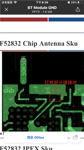

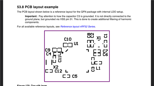

Hi
Our pcb follows the layout example. C3 is grounded. It is not directly connected to the ground plane, but grounded via VSS pin 31. But I have measured poor performance. I  connect C3 GND directly to the Ground plane and it will be normal efficacy. Is it ok to directly connect C3 to ground? Does it have other effects?
