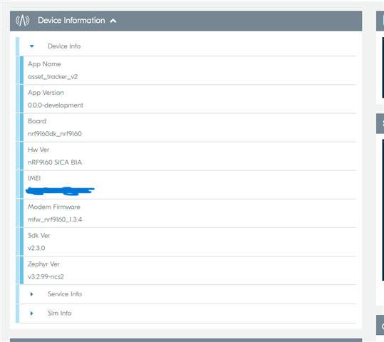

I am currently attempting to finish the getting started aspect of the nrf9160-DK and am having a few problems. I have no problem flashing the MFW and hex files onto the device via nrf connect. However, my problems start when I access nrfCloud. Whenever I am told to activate the SIM card, it goes through perfectly fine and activates. When I attempt to activate the device, the screenshot below shows the message in red. LED 3 blinks for a while then transfers to LED 2 blinking (to which I cannot find the significance of). I'd then go to check what is going on with the SIM card to which it then shows the message "Not connected to any device". I've already updated it with the latest firmware and hex files. I even made sure that the coverage is accessible in my area and tried using the legacy asset tracker v2 file. Is there something I am doing wrong?

  • I've attached the entire file below. I still have it running in the background just in case its status changes. Also, the AT+CFUN? gave me a numerical value of 1.

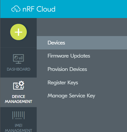

    Is your device visible under Device Management -> Devices in nRF Cloud?
    Also, have you updated the certificates on your device?
