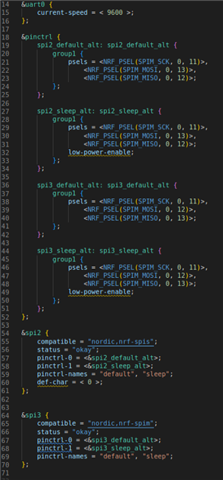

  • Is my devicetree overlay file correct for this SPI configuration?
    • In general, my understanding of devicetrees struggles, especially the use of 'pinctrl' over the deprecated miso-pin, mosi-pin etc.
    It looks to be OK. I was not able to spot any errors. But I am not sure about the pinout, are they not connected to the flash on your board (External memory)?

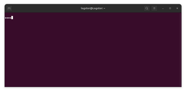

  • Hi Vidar, thanks for the answer! :)
    Below is a screenshot of my serial terminal running baud 9600 as specified in the overlay for uart0. I flashed the same program to the board, but with CONFIG_RESET_ON_FATAL_ERROR=n. On initial reset the first two question marks, and then on another manual reset with reset button, then the other two came. For some reason it's like it turns off the uart logging backend?

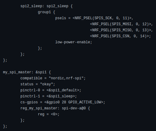

    I've looked at your colleagues example, and I can see that I've done some things right, but there's also a couple of things I don't understand in his devicetree. Below is a screenshot of a small part of his devicetree, here I don't understand why SPIS_CSN pin number(14) doesn't match 'cs-gpios' pin number(28). Is it because he connect pin 14 and 28 with a physical wire?
    Lastly, I dont understand the 'reg_my_spi_master'. What does it do, and why is it necessary. I see it in his code, but unfortunately I still don't get it? :)

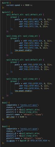

    Picture of my new devicetree overlay below. I've added the SPIS_CSN to the spi2 pinctrl, and added 'cs-gpios' to the spi3 with the same pin number as SPIS_CSN, because I intend to not use any wires. If that's possible of course.
    I think I need to get the logging to work, and then be sure my setup with no wires and spi2 and spi3 sharing pins is possible, before I update all the code and try again.
