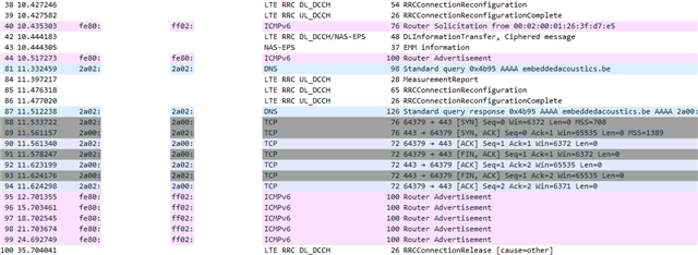

I am trying to setup a secure connection using an IPv6 TLS socket on my nRF9160 device, but it fails with errno=45.
To setup the socket I perform these steps (stripped of logs and such for clarity):

I have captured a trace of what happens at the modem. I do see the modem receiving the address of the server that I am trying to reach, some back and forth messaging is going on but a connection is not established. I do not see any TLS related messages either, nor do I see any AT messages indicating that the certificate information is sent to the modem at all.
Other than that I don't really know what to make of these logs. Maybe someone here can be of help.
