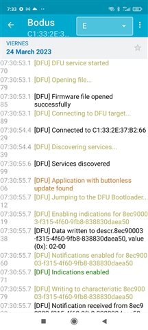

I have a firmware working properly at bluetooth DFU when using apps "My-nRF52 Toolbox" or "nRF Connect for Mobile".
But if I use app "nRF DFU" I get "error: the device does not support nrf52 dfu".
I get similar error with my own app buid with "Android-DFU-library".
I am using nRF52840, with nRF SDK 17.1.0 through Segger, and DFU zip file is   built with latest nrfutil version.
Please find attached the verbose log I get at "nRF DFU".

    From what I can see in the log, the app managed to connect to your application but when switching to bootloader it doesn't see the bootloader advertising, instead it's the application was running.

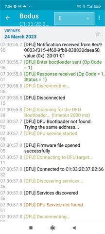

    From the log in the screenshot what I can see is that after the app switch the application to DFU mode the app couldn't find the bootloader (usually at original address +1  ) when it couldn't find the bootloader, it try to connect to the original address and then it couldn't find the DFU service, most likely the normal application was running, not the bootloader.

    If I understand the extra code correctly, when the bootloader starts it will blink some LEDs and this can take about 1.6 seconds.
    And if you notice in the screenshot, the timeout for the DFU library is only 2 seconds Relaxed   So what happened was that when scanning for the bootloader (address +1), the DFU library couldn't find it and then it gave up and looked for the original address. When connected to the original address (most likely the application) it couldn't find the DFU service.
