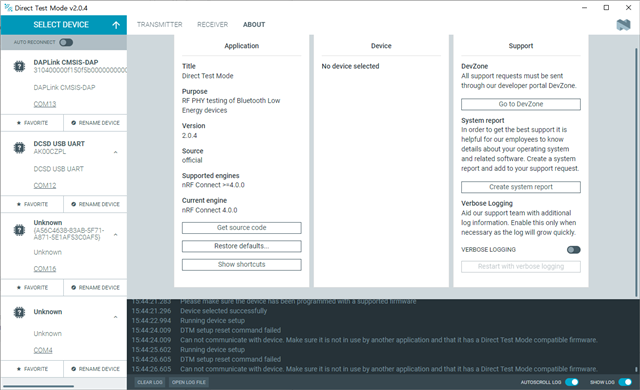

The Direct Test Mode(v2.0.4)  app in nRF connect Desktop(v4.0.0) recognizes COM PORT by the cypress USB-UART controller IC,
but the device selection is not successful and cannot DTM test proceed.
In the previous version(v2.0.3), it was confirmed that it works OK.
nRFgo STUDIO also recognized and operated OK.
I have other USB-UART controller ICs such as FTDI, SiLabs, CMSIS-DAP, etc. were recognized and selected successful.
Please let me know how to downgrade the DTM app within nRF Connect Desktop or how I can work around this.

    Could you please let me know if there are any error logs when you select the Cypress Device? Even if there is no error, what does the app's log says?
    I am not familiar with the tool on the second screenshot you posted, where the test is running. Is this on the nRFgo STUDIO app or a different app?

    1) No log is displayed when selecting Cypress Device. I attached the system report in About > support is as follows.
    COM13: DAPLink CMSIS-DAP
    COM12: FTDI
    COM16: SiLabs
    COM4: Cypress (<-- )
    2) The second screen shot is the interface that appears when selecting the Direct Test Mode item from the Bluetooth item in the Feature tab on the left after running the nRFgo STUDIO program.

  • Thank you for the information.
    The app team has confirmed that there currently is no way to downgrade the app to an earlier version.
    I have forwarded the new information you sent to our app team. As you could see, nothing specific about COM4 is shown, so I am not sure if this would be all it takes to pinpoint the issue. Let's wait for their response.

    There is one last thing we can try. Could you try turning on Verbose Logging? It is under the Support card of the About pane.
    After that, please click on Restart with verbose logging button then reproduce the issue with your Cypress device and send us the logs from clicking the
    Open Log File button, which is located at the bottom of the log window.
    Hopefully there is something obvious in the verbose log that could help tell us what is wrong.

    I got feedback from our team that it looks like an issue where the app does not handle devices without serial number well. Unfortunately, we don't currently have a workaround for this.
    My apology for the inconvenience. I will keep this ticket opened and inform you when a fix or workaround is available, or if the app downgrading feature is released.
