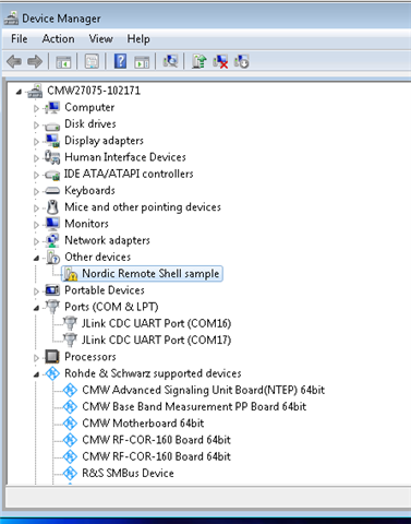

I am trying to test the nRF534 DK with my R&S CMW270 but i am not able to connect. i can see the Jlink ports but could not get a connection with either of them. I was able to program the DK to DTM mode using the nRF USB port but the CMW doesn't recognize it. It sees it as "Nordic Remote Shell sample."
Do you a driver i can use or different instructions to use the CMW?
  • Hi Jesse,
    I am not exactly sure what the issue is.. I checked with my colleague again and was informed that the CMW should be fine with the com port by itself.. Could you make sure if you are using UART and not HCI.? This might also be an issue on the CMW side.. Could you also check with R&S if that's the case.?

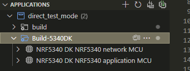

    I was able to get the our 5340-DK working and now i can verify it is in DTM mode by using nRF Connect. my CMW270 also now recognizes it and I'm able to measure TX/RX.
    I had to create a new build and reprogram it again but it seems to be working now. Maybe I didn't do it correctly the first time but I didn't get any errors when programming it.

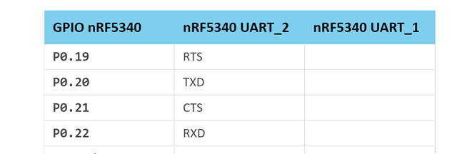

    But now I wanted to test my board that's using a nRF5340-CLAA, and I am running into the same issue. I have modified the nrf5340dk_cpuapp_common-pinctl.dtsi to the pins i want to communicate with. I'm using a 1.8 FTDI cable since we are using 1.8V to power the nRF5340.
    But i can't get any communication and the nRF Connect DTM app doesn't see it.
    below is how i set my UART lines to the desired pins on the "nrf5340dk_cpuapp_common-pinctl.dtsi":
        uart0_default: uart0_default {
            group1 {
                psels = <NRF_PSEL(UART_TX, 0, 27)>;
            group2 {
                psels = <NRF_PSEL(UART_RX, 0, 28)>;
                bias-pull-up;
        uart0_sleep: uart0_sleep {
            group1 {
                psels = <NRF_PSEL(UART_TX, 0, 27)>,
                low-power-enable;
