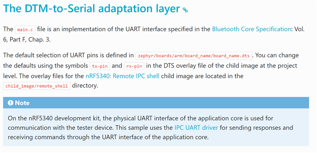

    But now I wanted to test my board that's using a nRF5340-CLAA, and I am running into the same issue. I have modified the nrf5340dk_cpuapp_common-pinctl.dtsi to the pins i want to communicate with. I'm using a 1.8 FTDI cable since we are using 1.8V to power the nRF5340.
    But i can't get any communication and the nRF Connect DTM app doesn't see it.
    below is how i set my UART lines to the desired pins on the "nrf5340dk_cpuapp_common-pinctl.dtsi":

    I am still having issues using DTM on my custom board with the nRF5340. i have modified the cpuapp overlay to the TX/RX pins i have for UART but I still cant get any communication when trying to use the DTM in NRF Connect foe Desktop. Any suggestions?
    I have change the CPUapp overlay to

    I have kept the cpunet overlay as
        chosen {
            ncs,dtm-uart = &uart0;

  • Hi Jesse,
    It should work properly if all you have done is change the UART pins according to your hardware.. Which version of the SDK are you using.?
