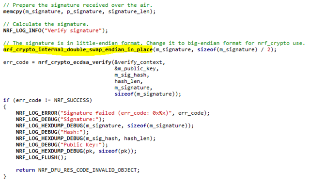

I have displayed the signature of the package .zip I generated with nrfutil by typing :
nrfutil pkg display [filename.zip]
and it corresponds to the signature in the logs but with first and last halves switched.

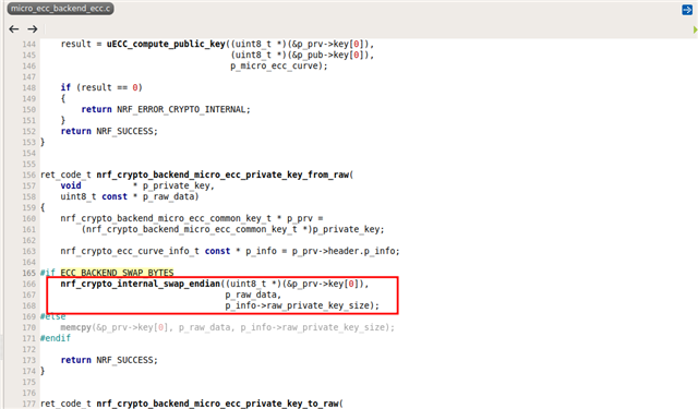

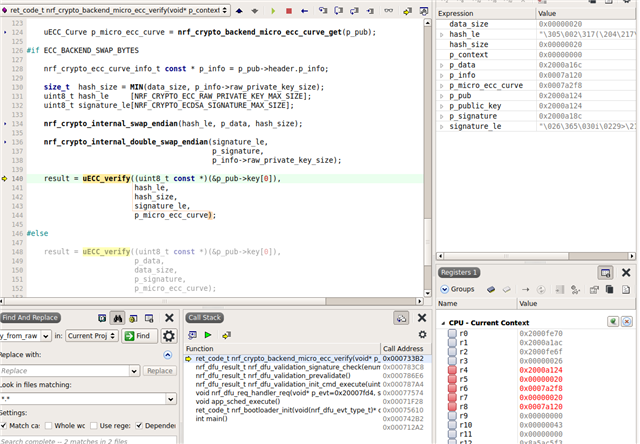

  • This is why debugging crypto services can be hard at times Slight smile Anyway I am glad to hear that it works now. Thank you for updating the ticket.
    Adding logging to the "release" bootloader can be a bit cumbersome as it does not include the logger dependencies by default. Nor does it have enough flash allocated to it. This is why I usually try to just debug the bootloader with optimizations enabled and without logging first. The screenshot I posted earlier that showed the paramaters passed to uECC verify was with optimizations enabled.
