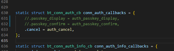

I have a working example of BLE HIDs mouse in nRF52DK. I changed the HID report and works ok in Windows 10.
My problem is I need to connect to PC without confirming connection from MCU side. I tried disabling SMP and it connects automatically, but then after a few seconds, Windows shows "driver error"
Any suggestion? Is it possible to pair with Windows without SMP? Any way to use SMP and automatically accept connection? Any way to do not see the confirmation numbers from Windows?

    By spec, the communication between a HID device (mouse/keyboard) and the host must be encrypted. It's not allowed to have open connection for a mouse/keyboard for security reason. So Windows expect the device to support SMP (pairing) if the device doesn't have it supported Windows will display "Driver error".
    One option I can think of is to run your own application on Windows. Then you can make your device connect to Windows via the app. It doesn't need to be HIDs hence doesn't require encryption. Your app on Windows should be incharge of converting BLE data to mouse/keyboard input to Windows.

    Thank you for your answer. I need to use HID so I will enable SMP and automatically accept connection from MCU.

    I've done several tests and the first time worked doing exactly same as you (Only comment these 2 lines, rest of the example untouched). But then never worked again.
    It can't connect and I see the following messages:

    The example is untouched except for display and keyboard callbacks that are commented.

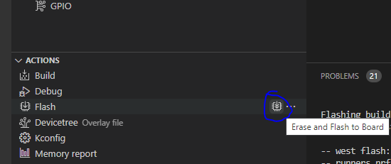

    I would suggest to do a full erase of the chip before testing. On PC, in addition to remove bonding please also try reset the device.
    That was the problem! I thought when flashing from vscode and says in first step "Erase file" it erased the chip fully, but no. I "Erased all" from nordic programmer and then flashed again and now it works!
    I think it had in the memory some bond data from when it was paired using mitm and that was the problem.
    Can I suggest adding "Erase all" option in vscode pluggin?
