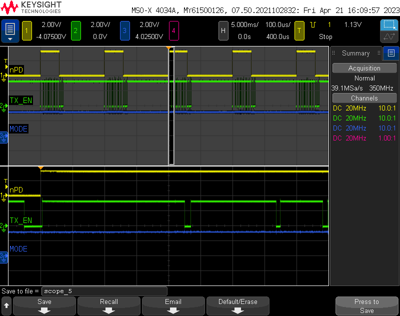

    I could not reproduce your results with the patches you provided. I applied the patches to the original LE audio sample code and measured the nRF21540 signals on the nRF5340 Audio DK, but without connecting the shield. I measured the following:
    • PDN signal on P1.10 is fixed low
    • MODE signal on P1.13 has 6 positive 91us pulses every 10ms
    • ANT_SEL signal on pin P0.31 has a 3.84ms positive pulse every 10ms interrupted by 5 negative 15us pulses
    • TX_EN signal on P0.30 I could not measure because it is only routed to RGB2_LED
    • RX_EN signal on P1.12 is fixed low but with strong noise (interference from SPI CS?)
    Because P1.10 could collide with a netcore UART signal I re-mapped the PDN signal to P1.14, and because I could not measure P0.30 I re-mapped the TX_EN signal to P1.00. Now I measured the following:
    • PDN signal on P1.14 has 6 positive 56us pulses every 10ms
    • TX_EN signal on P1.00 is fixed low
    P1.14 has now exact the waveform of the TX_EN signal of the original LE audio sample, but it is mapped to the ble_hci_vs_cp_nrf21540_pins.pdn field in ble_core.c. Equally P1.13 corresponds to the PDN signal but is mapped to the ble_hci_vs_cp_nrf21540_pins.mode field and P0.31 corresponds to the MODE signal, but is mapped to the ble_hci_vs_cp_nrf21540_pins.antsel field.
    My conclusion:
    • At least P1.10 (but probably P0.30 also) cannot be used as a nRF21540 signal.
    • The vendor specific HCI command HCI_OPCODE_VS_CONFIG_FEM_PIN is differently interpreted on the controller side and therefore the signal mapping gets mangled.
    Can you agree with my conclusions?
    Is it possible to provide us with a controller image, which correctly maps the nRF21540 signals and the netcore UART and LED signals do not interfere with the nRF21540 signals?
    Benno

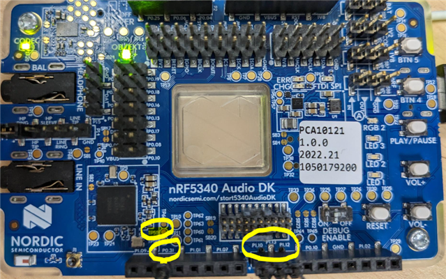

    P0.30 is a bit tricky, it is exposed on TP59 here:
    Are you able to provide the generated device tree file (zephyr.dts) as the developer requested?
    Vidar
