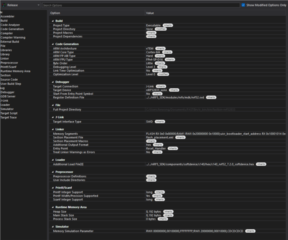

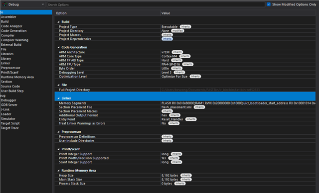

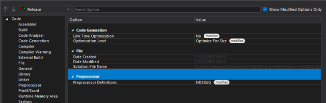

- Is there any difference between the Release and Debug build configurations for the source file that are having issue?

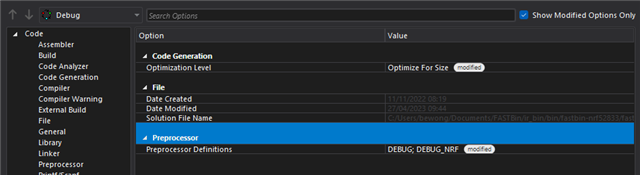

Release modified:
Debug modified:

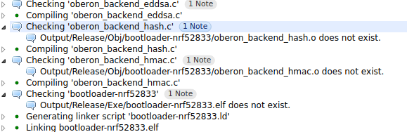

Tested this and it seems to fail on first attempt but builds on second attempt? At lease the output file seems to work

I'm not sure which version is correct for me, but I was able to narrow it down to either 4.50 or 5.42a.
4.50 was giving me an error when I open SES itself. Using 5.42a, it seems to be doing the same thing where it seems to be able to build on second attempt. First attempt yields this error message:
(i did clean the previous build as you suggested in your other comment.)
Edit: This was on linux btw so I'm not sure why it's looking for a windows file path

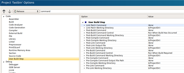

No this isn't an example program. The command that it's trying to run is a nordic command line tool that is merging the softdevice and our bootloader file that is created earlier during the build process. Seeing that it is under post-build commands I google it and found it would be related to the post-build commands but when I look at that option in my SES options for the project it seems empty(pictured below). Do you know if there are any other fields that it could be using to find the directory to the tools?
For finding how the build is setup, both the Release and Debug configurations could be inheriting from the Common configuration. Try looking at that.

It was happening in Release but not Debug so it wouldn't be that, but I did find the issue. There was a line in the .emproject for post build commands that was running that mergehex.exe but it wasn't showing up in the IDE. deleting the line fix the issue
