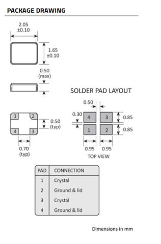

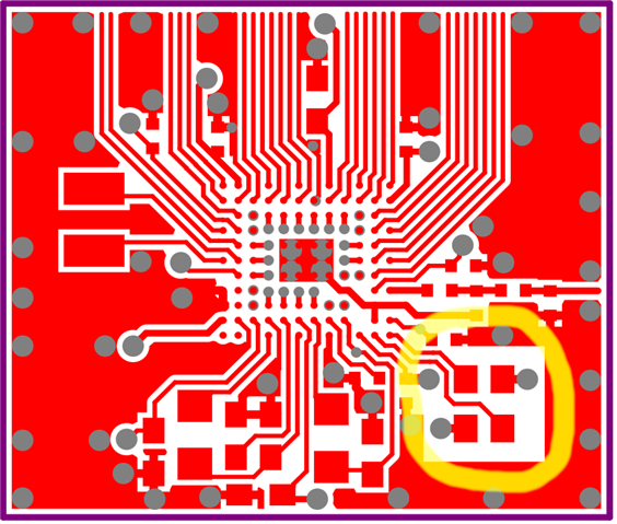

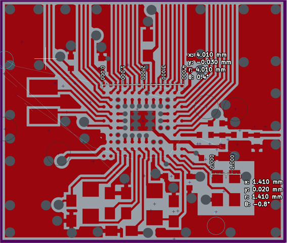

I have been following the reference layout designs for the nrf5340 CLAA variant that Nordic publishes (the 4x4mm chip). In particular the "nRF5340-CLAA Reference Layout - Config 3" layout. I am having trouble finding a 32Mhz crystal that matches the footprint on the layout: "XTAL_2016". In fact, the nrf5340 DK uses the exact same footprint and the BOM states that the MP06003 part number is used. The nrf5340 Audio Dk uses a CX2016DB32000D0WZRC1, also in a XTAL_2016. However, these parts are about 30% larger than what is shown in the CLAA reference layout.
What part was used for the config 3 reference layout linked below.
