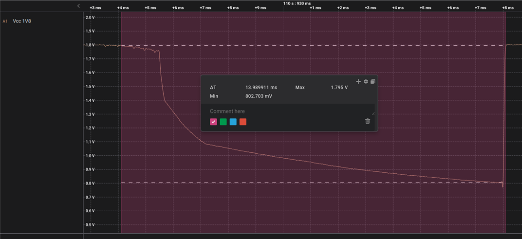

The problem I'm facing is that sometimes we have short power failures in our system, and this seems to disrupt the behavior of the anti-brick system. I have observed that if the power failure is too short in time, the boot counter is not reset to 0 but kept to the the last value.
The MCU's Vdd is 1.8V. I've made some measurements where I can observe the issue.
In this measurement, we can see that the duration of the power outage is about 12.3 ms. Vdd starts at 1.8V, then drops to 800 mV, and then goes back to 1.8V.
Best
joël

    During the design process, I assumed that sufficient power loss that causes a brownout reset would clear the content of the memory, and thus the boot counter would be 0 at boot. Now I am facing this issue I am not sure about this assumption anymore. My main problem is not the behavior of the anti-brick system, but the validity of the RAM state after a power up if there is a short power outage (a few milliseconds in my last measurement). The anti-brick system just exposed the issue. To fix this, I could simply clear the boot counter if the reset cause is coming from a brownout, but that is not my question.

    The various support circuitry will be in a know state after a reset, yes, such as the ABH bus and memory controllers. Just not the memory content itself. I am not a hardware designer, but I assume that designing a RAM that could be fully reset would increase either the cost or the power consumption, or both.
    joel-sc said:
    Is there any specification regarding the power down an up sequence in term of voltage and timing ?
    Not really. The power on reset functionality ensures that the device is not powered up until a stable supply is available.
    We do have some specifications regarding how the rise time of the supply affects the device startup time, which you can find here. Essentially a slow rise on VDD will increase the time the device is kept in reset by the power on reset circuitry.
    joel-sc said:
    Can I assume that at the beginning of the reset handler, the whole CPU is in a sane and valid state, this is true _every_ time ?
    Yes. This is the responsibility of the power on reset functionality, and the overall reset feature of the various peripherals and system blocks, to make sure that your device doesn't start until it has a stable supply, and that all peripherals are reset to a known state when the CPU starts running.
