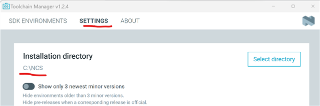

  • Could you try upgrading the JLink to a more recent version? Now it's in v7.66a
    Also, where do you have your VSCode workspace, i.e. where is the folder that you save your VSCode projects located at? For eg, mine is as shown below:
    -Priyanka

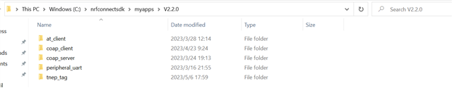

    My VSCode projects are located at the position as below.

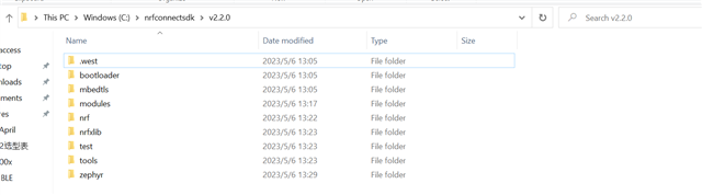

    My NCS is located at the position as below.

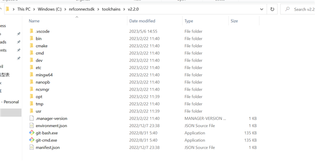

    My Toolchain is located at the position as below.

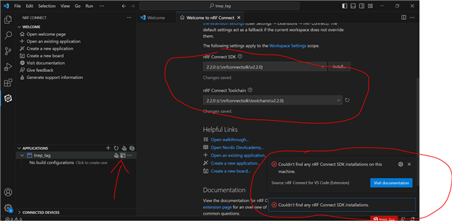

    It could find the Toolchain path now, but It popup a reminder of "Couldn't find any nRF Connect SDK installations".

    Also, could you send a screenshot of your installation path under "settings" in Toolchain Manager?
    -Priyanka
  • Dear Priyanka
    Sorry for that, I have already answered this question as the below picture .
