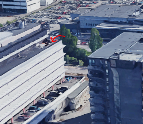

    I tested in another place today, on top of an 8-floor building inside of the city. The situation is a bit different,
    when the device connects to 24001, still no GNSS fixes, usually only 1 satellite is tracked.
    when the device connects to 24007, several satellites are tracked, but still no GNSS fixes.

  • Hello again, our R&D team have looked at the modem traces and your case.
    Their initial response is that the GNSS reception is not good. Could you give a more precise description of where you are testing? Are there any walls around you, or metal, etc. The GNSS receiver alone is quite sensitive, and the antenna on the Thingy:91 is shared between the LTE and GNSS, which can cause lower performance.

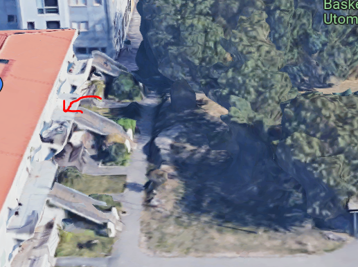

    I attached two pictures, they are the Google 3d map of the two places.
    Place 1 is in a residential area that is a bit far away from the city center,
    Place 2 is on the top floor of an 8-floor building near the city center.

    No, unfortunately not. As I mentioned earlier, the antenna on the Thingy:91 is smaller than the one on the nRF9160DK. This can cause the signal level to be right on the edge of being usable, which again is boosted with a dedicated external antenna.
    Our engineers had a look at the traces that you provided again, and based on location in modem traces and Google Maps they write the following answer:
    The building is in W-E-direction and it blocks sky view to north - so low elevation SVs in northern sky are difficult to receive - but whole southern sky should be hearable.
    There seems to be some sort of interference at the location, which is always difficult determine. The Thingy:91 is a prototyping platform, designed to be a proof of concept to work all around the world. In order to improve the antenna, you will need to design you own HW and provide an antenna that fits your needs.
