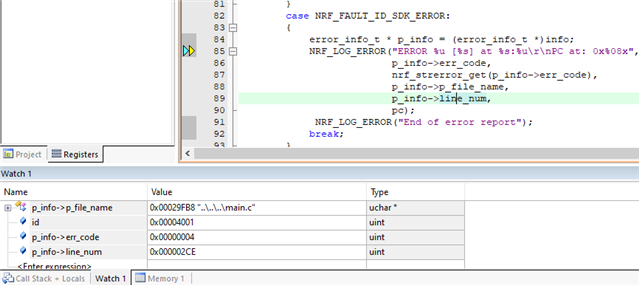

    Then look at the error handler, and see what APP_ERROR_CHECK(err_code) it points to. What is the value of err_code, and what function that returned that err_code?
    You should stop in the app_error_fault_handler. You can step abit inside here to see the ID of the fault (probably NRF_FAULT_ID_SDK_ERROR), an dthen you can see the file name and line number of the APP_ERROR_CHECK(err_code), and the err_code itself:

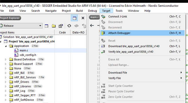

    4: Attach debugger! It is important that you don't just start a debug session like you normally would, because this will upload a modified application file. Instead you need to attach debugger, which will then assume that the application is already programmed, and start the debug session. The problem with uploading the modified application file is that changes in the flash will cause the bootloader to reject the application, and it will enter DFU mode.
    So try to include the ble_dfu_buttonless_async_svci_init() again, and follow this guide, and see what happens.
