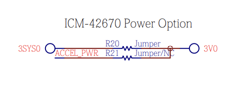

ICM42670P and nrf52832 were tested in examples such as spi and spis to configure them as SPIs, but data could not be received.
Can someone help me?
configured with sdk 17.1 s132
Even if I try to check the register for WHOAMI, I'm only getting an empty value.

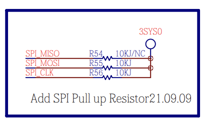

This is part of the circuit diagram.
I set the "ss" pin to 20, the "miso" pin to 29, the "mosi" pin to 28, and the "sck" pin to 27.
  • I will ask my colleague to look at your schematics on Monday, but before that, can you please show some code snippets and the pins output when you send the command to the sensor to know the status of the WHOAMI register?
    What is expected on pins and what do you see?
