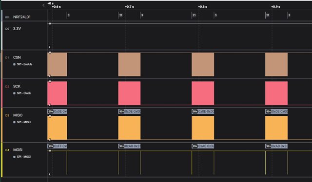

    Even if you're right that my part is not genuine, it seems to work correctly.
    Here after are some evidences. I use a digital oscilloscope to get them. It also to decode the nRF24 protocol (see information squared in grey).
    1. Frames exchanged every 100ms between Arduino transmitter and nRF24.
    2. At the begining of each frame, there is a TX payload.
    3. After the TX payload, it seems to wait for the ACK from the receiver.
    4. At the end of the frame, finally with no ACK, the trnasmitter decides to stop.
    Best regards.

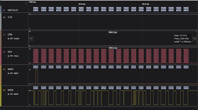

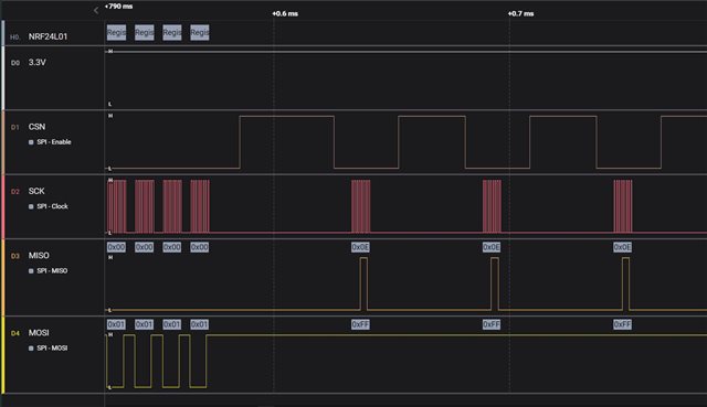

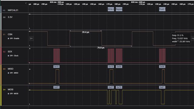

  • Hi
    It looks like you are using the Saleae Logic analyzer. Would you be able to attach the trace files to the case so I can look at them directly?
    Also, would you be able to do a read out of all the configuration registers after you have run all the init commands?
    Probably the Arduino libraries don't have a function for reading raw registers, but doing so is as easy as letting the first byte of the SPI transaction be a number between 0-0x1D, and reading the bytes that follow.
    The SPI commands are described on page 51 of the nRF24L01+ product specification (you would use the R_REGISTER command to read the registers), and the various registers are described from page 57 and out.
    Best regards
    Torbjørn
    I put a link to the sal file from Saleae logic analyzer which captures SPI during more than 2 seconds. 2 frames have been ACKed (the 2nd one and the 15th one). All others, no ACK.
    I used the function printPrettyDetails of the Arduino library to get information about configuration of radio. Here after are the results. Let me know if you need more.
