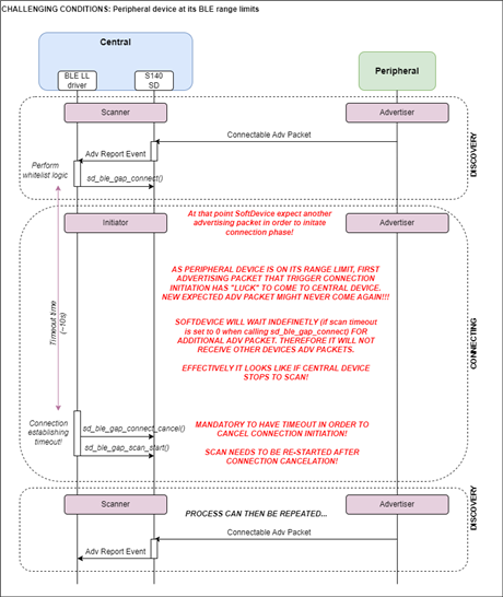

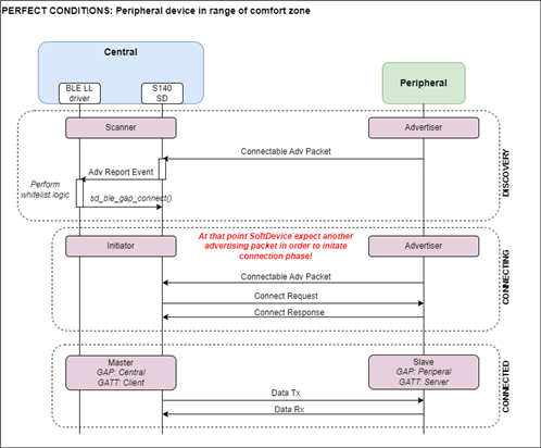

  • I think I got it! But there is still a lot to be tested before celebration Slight smile
    PROBLEM
    WHAT: Central device did not end connection initiation procedure, no timeout was implemented! Calling "sd_ble_gap_connect" with scan timeout of 0 will never timeouted!
    WHY: After calling "sd_ble_gap_connect" additional advertising packet needs to be received before SD start to send connection request to peer device. In case of DevB adv packets were received very reliable and connection establishment was done immediately. In case of DevA that was on rangle limit its adv packet come very offset and very randomly. So between first and second adv packet it might pass couple of minutes or it might take indefinetly. Central was therefore blocked waiting for that second adv packet. And from outside it looked like it stop to scan. (Here I was misdirected...)
    SOLUTION: Implemented timeout for connection initiation (when first calling "sd_ble_gap_connect") and at timeout event calling "sd_ble_gap_connect_cancel".
    In picture below there is a sequence diagram of described scenarious for both devices:
    Similar issues were discussed on several Nordic Dev Zone post, but unfortunatelly I wasn't come across them before:
