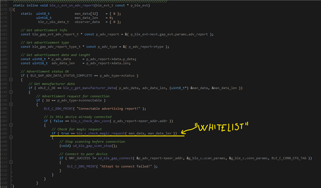

    Any chance you can upload the file where the whitelist implementation is done so we can take a look at how you've implemented this?
      I have a feeling that you read my post/answers superficially, as I already upload code and pointed out where to look for whitelist implementation:
    Central device is using whitelist, but custom implemented one. It simply check for manufacturer data inside connectable advertisement packet and if that data match it tries to connect to that peripheral (look at the attached code inside "ble_c.c" line 1175: ble_c_evt_on_adv_report).

    I'm sorry, I did indeed miss the paragraph where you explained where to find your whitelist. From the following part of your ble_c_evt_on_adv_report();
    // Advertisment status OK
        if ( BLE_GAP_ADV_DATA_STATUS_COMPLETE == p_adv_type->status )
            // Get manufacturer data
            if ( eBLE_C_OK == ble_c_get_manufacturer_data( p_adv_data, adv_data_len, (uint8_t*) &man_data, &man_data_len ))
                // Advertisment request for connection
                if ( 1U == p_adv_type->connectable )
                    BLE_C_DBG_PRINT( "Connectable advertising report!" );
                    // Is this device already connected
                    if ( false == ble_c_check_dev_conn( p_adv_report->peer_addr.addr ))
                        // Check for magic request
                        if ( true == ble_c_check_magic_request( man_data, man_data_len ))
                            // Stop scanning before connection
                            (void) sd_ble_gap_scan_stop();
                            // Connect to peer device
                            if ( NRF_SUCCESS != sd_ble_gap_connect( &p_adv_report->peer_addr, &g_ble_c.scan_params, &g_ble_c.conn_params, BLE_C_CONN_CFG_TAG ))
                                BLE_C_DBG_PRINT( "Attept to connect failed!" );
    Do you get either of those two logs printed when device B gets back into range whenever it's not able to reconnect because of device A "still" being out of range? Additional logging might be helpful to get a better picture of what's going on.

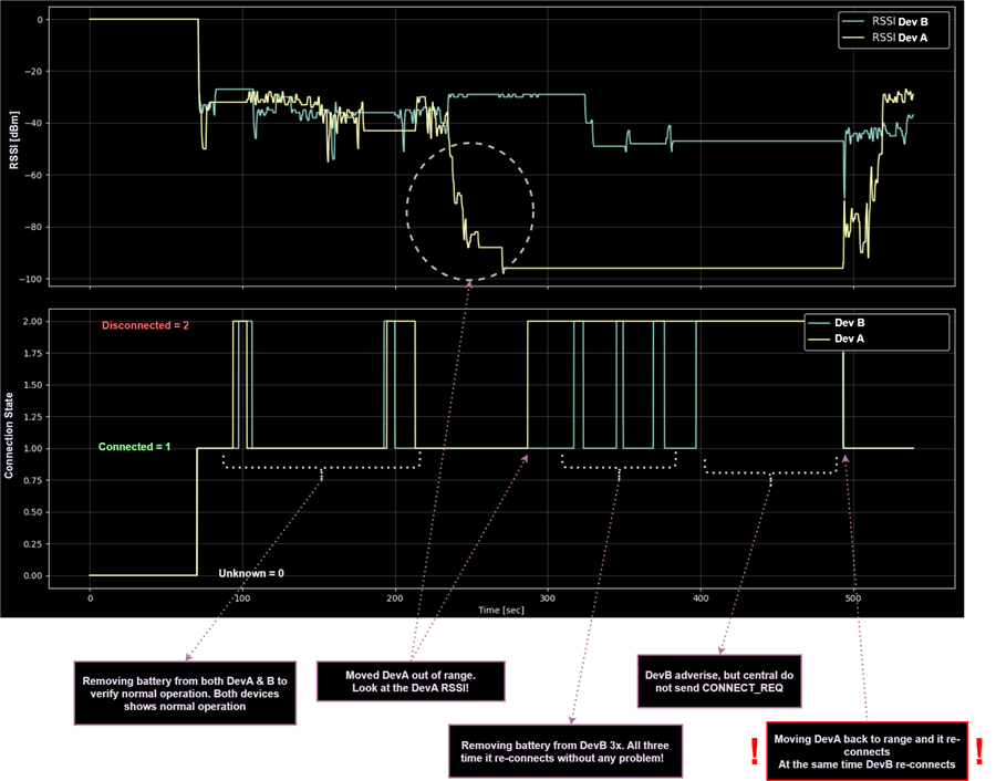

  • Hi  ,

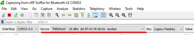

    From the sniffer trace I hoped to see Device B as well, to see if it shows up as advertising at all when device A and then device B is moved out of range, and if there is in fact a connection request to device B made. But it seems like you only connect to Device A, then reconnect to it, is that correct?
    Yes, I filter out the device B as I wanted to show you also connection packets and therefore selected only DevA:
    Do you see that Device B actually advertises, either on the central device, another central device, or sniffer trace after both devices are moved out of range, and device B is moved back into range?
    I repeated the measurement with two nRF52840-DK sniffers, one is observing DevA and other DevB. Measurement confirms that DevB is actually advertising.
    A take a step further and logged connection state and RSSI of DevA & B simultaneously with Wireshark sniffer. There is some minor (less than 5sec) difference between start of logged file and start of sniffed file. As I was not able to start it all at the same time manually. So sniffed and logged data are soft of synchronised.
    Sniffed files:
    MAC Addresses:
    Central: E2:1E:EA:19:77:C2
    Peripheral DevA: DD:5F:43:78:58:0E
    Peripheral DevB: CE:AA:75:A4:1C:F1
    Same test actions were done as with previous measurement (look at my previous post).
    OutOfRange_DualTest_DevA__2__01_06_2023.pcapng
    OutOfRange_DualTest_DevB__2__01_06_2023.pcapng
    Logged measurement connection state & RSSI:
    Measurement conclusion:
    DevB is advertising while DevA is still out of range. Cetral Dev is not initiating connection (not sending connection req) towards DevB. After DevA is moved back to range, both devices are re-connected and normal operation is re-established.
    Yes, as confirmed with sniffed data, DevB is advertising when DevA is out of range and sort of "blocking" the connection with DevB. Those two logs are disabled as BLE_C_PRINTF is blocking in nature and therefore program might be blocked for too long in observer handler.
