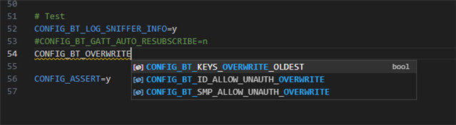

  • Hi Edvin,
    I'm using bonding to automatically connect to yet paired devices. The problem is once you reach the max paired devices (CONFIG_BT_MAX_PAIRED) it does not automatically delete the oldest one to have space for the newest one. Just there is an error in the connection (Normally error 19, which implies host refused the connection).
    I'd like to know how to delete oldest bond, if CONFIG_BT_MAX_PAIRED is reached.

    I see. So I assume that you have the peer_manager up and running, then.
    You can use pm_peer_delete() to delete one  peer, or you can use pm_peers_delete() to delete all.
    In order to use pm_peer_delete() (to delete one), you need to have a peer_id which is a handle to the peer that you want to delete.
    To cycle through all your peers, you can use pm_next_peer_id_get(). To get the ranks of the peers you can use pm_peer_ranks_get(). Note that the ranks are not set automatically. You need to use pm_peer_rank_highest() (or *_lowest()) to set the rank of your peers, e.g. by which peer that was connected most recently. Read about it in the API descriptions from the links.
    So let us say that you will rank the peer highest whenever you connect to a known peer. If your paired devices list is full, you can use the pm_peer_ranks_get() to find the lowest ranked peer, and delete it using pm_peer_delete().
