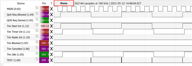

From the measurements it seems that the freeze happens within MPSL_TIMESLOT_SIGNAL_START where it appears to stop when trying to add an element to the message queue, where it halts and then never finishes the interrupt routine. But from the implementation it should not be possible to wait there (K_NO_WAIT), something else would even be not allowed as it is running in the context of the TIMER0 interrupt.

    Could it be that you are staying too long in the timeslot when the message queue fills up, since you are printing to the log every time k_msgq_put(..) fails?
    You mention a 500us runtime for the test when sending 100 messages, but I assume this is when there is room in the message queue for all of them?
    What if you keep the log message on the error, but exit the loop as soon as an error is returned (to avoid multiple errors in a row). Will the issue still happen?
    Best regards
    Torbjørn

    Maybe the fast example is a little bit extreme, but the application freezes can happen even when the buffer never gets full in the slow example.
    In the example the timing ensures that in one cycle all messages that are put in the buffer are also read afterwards. When activating the option that the buffer fills up, this causes that (after some time) per cycle only the last two of the 20 (or 100 in the fast case) messages have no space in the buffer anymore. Exiting the loop in this case does not resolve the problem.
    I commented out the logging when the buffer is full, as I wanted to make sure that the error is not appearing due to logging in the interrupt routine. In my actual application there sometimes also happened freezes when not using a message queue and just having some log messages in the interrupt routine (which still should be allowed), but for now I just wanted to focus on the problem the message queue might be causing.

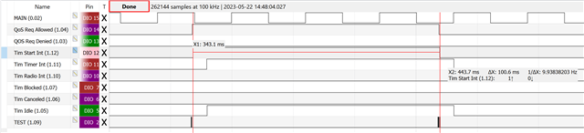

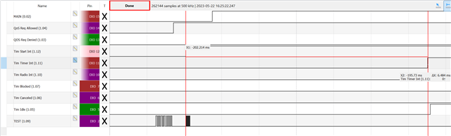

    The timing should not be a problem. Here some of my captures. In the top there is the main thread toggling every 15 ms. The next two rows indicate whether the timeslot request requested by the mpsl_timeslot_demo task is granted or not. The next few rows are toggled on certain timeslot events (start of timeslot, TIMER0 interrupt, when the idle status is reached, the others are actual not relevant here). The last GPIO is configured to toggle before reading a value from the message queue in the mpsl_timeslot_demo thread and before putting an element in the queue in the timeslot.
    This is how it looks as long everything is working.
    Between two timeslots there are about 100 ms, as i am always sleeping for that long before there is an attempt of requesting a new timeslot. From the timing chosen there is never the possibility that the timeslot request (guarded by a semaphore) is denied.
    The duration of one timeslot is 6.5 ms (it is configured 6.7 ms, but the TIMER0 triggers 200 us earlier) and in this implementation the timeslot is not ended otherwise. In my actual application I would end the timeslot when the sending of all data is finished, but keeping the timeslot open until TIMER0 triggers it can easily be seen that the operation fits without problems in the timeslot. Before the request of the timeslot 20 messages are read from the message queue. Putting the 20 values in the message queue after the start of the timeslot is even faster and took just 116 us.

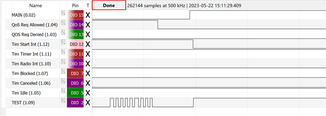

    And this is how it looks when it freezes. The rising edge at the bottom happens before the first element will be put in the message queue, and then no GPIO changes anymore.
    Even if I would stay too long in the timeslot I would assume from the documentation to get into the case MPSL_TIMESLOT_SIGNAL_OVERSTAYED which then should trigger an assert. However, from the timings it seems that it just freezes at the beginning of the timeslot without any further execution.
