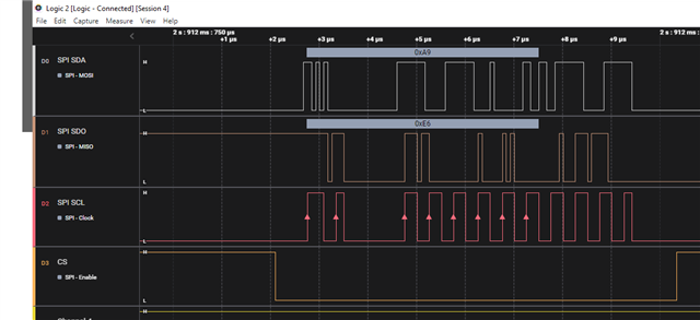

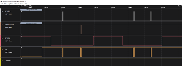

    I'm trying to get the signals on the oscilloscope to see if the behavior of the spi is visible, but still nothing.
    I tested the sensor on an arduino and it worked normally, so it's something I'm missing on the nRf9160.
    Any more suggestions?

    I would recommend that you use a logic analyzer to see which GPIOs are toggling.
    Håkon
  • Unfortunately I already tried with P0.08/P0.09 in the "NC" position, nothing...
