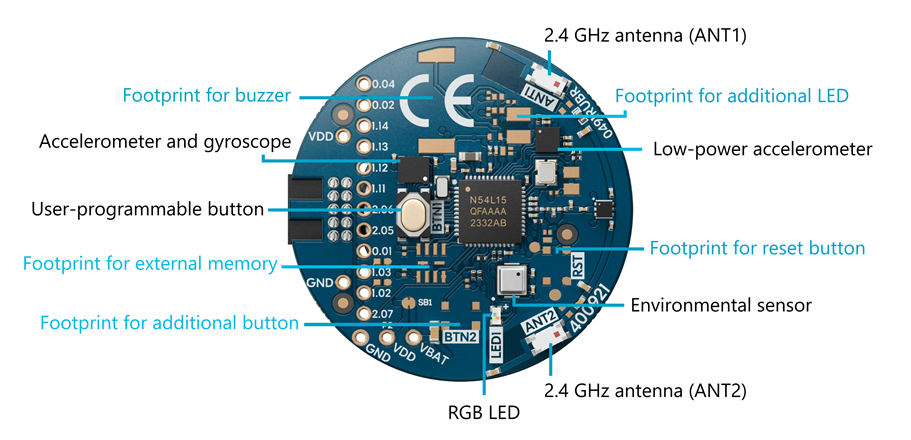

Feature overview
nRF54L15 Tag’s design is optimized for prototyping and creating proofs-of-concept for compact battery-powered products such as Bluetooth trackers, asset tags, smart wearables and remote controls. As a unique feature, the nRF54L15 Tag has two 2.4 GHz antennas that provide improved robustness for Bluetooth Channel Sounding. The antennas are toggled by a RF switch, and the toggling happens automatically during the Channel Sounding procedure if multiple antennas are configured in the firmware.
The sensor selection, shown in the sensor overview image below, is optimized for cost-efficiency for prototyping asset tags and Bluetooth trackers. nRF54L15 Tag features a low-power accelerometer for waking up on motion, a six-axis inertial-measurement unit for edge AI training data collection and prototyping products with smart features such as gesture recognition and movement tracking, and an environmental sensor for smart home applications. The design also includes footprints for additional sensors and buttons for expanding the functionality.
Key features of the nRF54L15 Tag are listed below. We will discuss them in detail throughout this DevZone blog.
Ultra-low-power multiprotocol wireless nRF54L15 SoC in QFN package with next-generation 2.4 GHz radio
  • Support for the following wireless protocols: Bluetooth® Low Energy, Bluetooth® Channel Sounding, Bluetooth Mesh, Matter, Thread, Zigbee, Aliro, NFC, 2.4 GHz proprietary
  • 1.5 MB NVM and 256 kB RAM
  • 128 MHz Arm® Cortex®-M33
  • Dual 2.4 GHz antennas providing improved robustness for Bluetooth® Channel Sounding
  • Low-power accelerometer (Analog ADXL367) for waking up on motion and extending the battery life
  • High-accuracy accelerometer and gyroscope (Bosch BMI270) for edge AI, sensor fusion, wearables, AR/VR and much more
  • Environmental sensor (Bosch BME688) for measuring temperature, humidity, air pressure and gas concentration
  • 1x User-programmable RGB LED for visual indication, demos and debugging
  • 1x User-programmable button for user-input handling
  • Powered by a CR2032 coin-cell battery – battery holder included
  • Footprints for an additional user-programmable button, reset button, RGB LED, buzzer and external memory for expanding functionality
  • Compatibility with Nordic DKs and SEGGER J-Link Debugger for programming and debugging

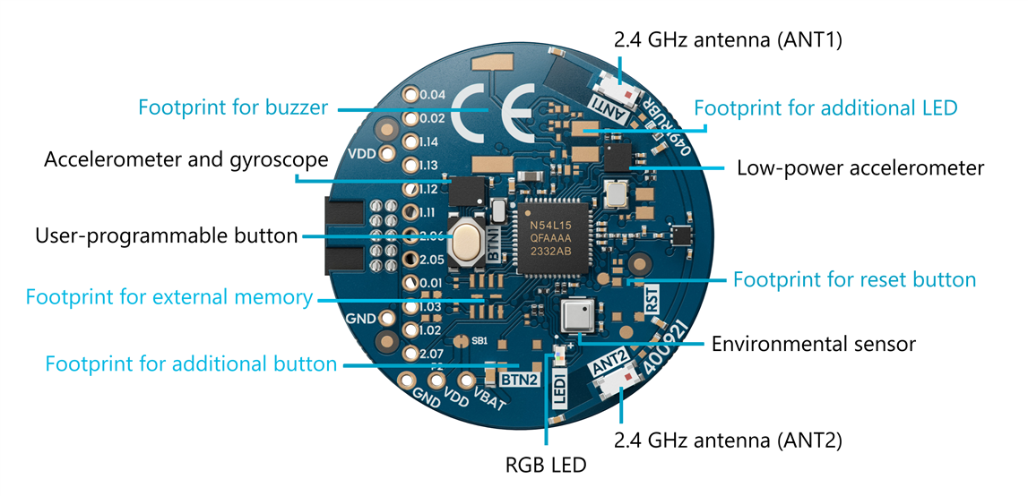

The image below shows an overview of the sensors and I/O found on the nRF54L15 Tag.
nRF54L15 Tag sensor and I/O overview

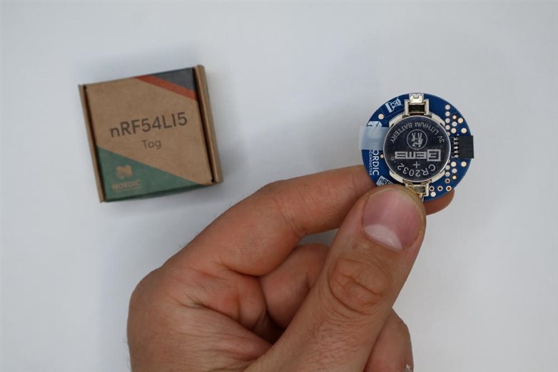

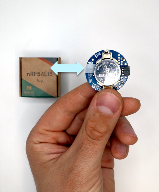

The nRF54L15 Tag includes a CR2032 coin-cell battery in the holder, separated by a small tab from the contacts. To power the tag, pull out the tab. The RGB LED will start blinking, indicating the tag is powered and running the preprogrammed Peripheral LED Button Service (LBS) sample.
Note: The preprogrammed Peripheral LBS sample is not power-optimized. Program the tag with a lower-power sample after unboxing and verifying functionality. We will cover programming in a later section.
Before programming the nRF54L15 Tag with different firmware, ensure the tag is advertising correctly. First, install nRF Toolbox on your phone. The app is available on Play Store and App Store; find more information on its product page via the link above.
Open the nRF Toolbox app and scan for nearby devices. Locate the nRF54L15 Tag advertising as “Nordic_LBS” and connect to it. The LED will switch from blinking to fully lit and change color. Toggling the Light button in the app will change the RGB LED color on the nRF54L15 Tag. This confirms Bluetooth communication works. You can then disconnect and close the app.

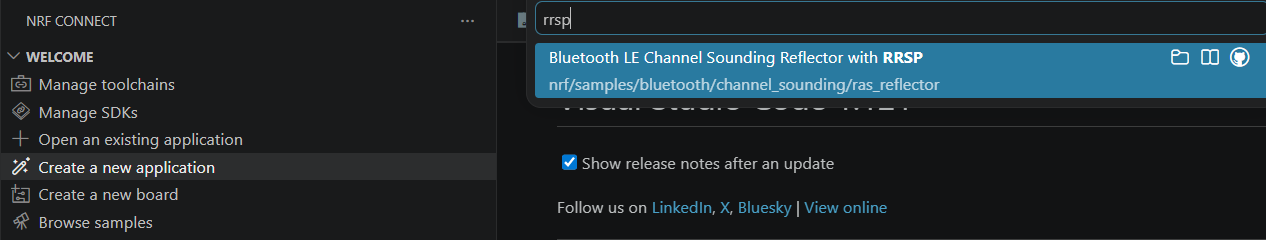

In this blog post, we will use the Bluetooth Channel Sounding Reflector with RRSP sample as the firmware to build and program on the tag.
In nRF Connect for VS Code, select Create a new application > Copy a sample > nRF Connect SDK > v3.3.1 (or newer) > Bluetooth LE Channel Sounding Reflector with RRSP, and then choose a name for the project, or go with the default name. See the screenshot below for the correct sample.

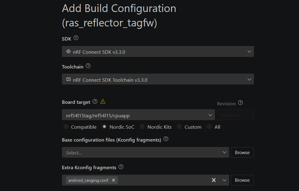

Once that is done, select Add build configuration and change the Board target in the build configuration to nrf54l15tag/nrf54l15/cpuapp to target the sample for the nRF54L15 Tag.
If you have a Pixel 10 phone for testing, add android_ranging.conf to Extra Kconfig fragments. In that case, make the same changes to android_ranging.conf as described above for prj.conf. To test the Reflector sample on the nRF54L15 Tag with a smartphone as the Initiator, visit Evaluating Bluetooth®︎ Channel Sounding with our open-source Android app on Google Pixel 10.
Otherwise, you may leave Extra Kconfig fragments empty and test the application with an nRF54L Series DK as the Initiator by following the Bluetooth: Channel Sounding Initiator with Ranging Requestor documentation. Note that the algorithm in the initiator sample only uses one antenna; for more advanced multi-antenna algorithms, we recommend working with our algorithm partners.
Select Generate and build and wait for the build to finish. For further information about building samples in the nRF Connect for VS Code extension, please see the TechDocs instructions for building an application.

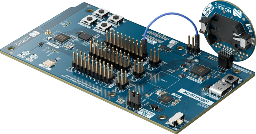

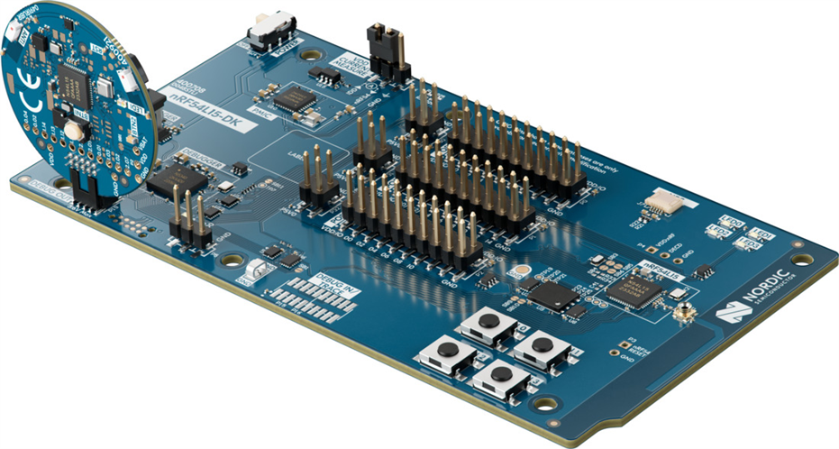

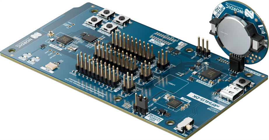

Let’s go through these options one by one. To program the nRF54L15 Tag using a DK, start by getting an nRF54L Series or nRF91 Series DK in front of you. You may also use any other Nordic DK for this, but nRF54L Series or nRF91 Series DKs are recommended because the voltage is matched for the nRF54L15 Tag in these cases. If you have for example an nRF54L15 DK or an nRF54LM20 DK, either of these will do. You can find all recommended DKs in the Related development hardware section on the nRF54L15 Tag product page.
Check the pin alignment tab on the header and plug the nRF54L15 Tag into the DEBUG OUT port of the nRF54L Series DK as shown in the image below.

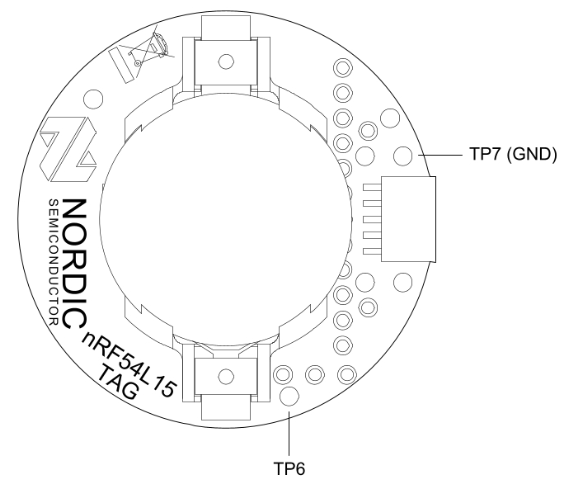

By default, the DK will not power the nRF54L15 Tag through the DEBUG OUT port, so you will need to power it with the CR2032 battery that comes with the kit. See the image below for clarification.
Alternatively, you can power the nRF54L15 Tag without a battery by supplying 3.3V to VDD SWD0, as shown in the image below. You can use VDD:IO from P2 to supply the 3.3V. However, you MUST ensure that the battery is not in place when power is supplied through the DK, as this can cause overheating and damage the nRF54L15 Tag, battery or the DK.
After plugging the nRF54L15 Tag into the DK and powering the tag, you can program it like you would normally program the SoC on the DK. Navigate back to your project in VS Code, select the ras_reflector application in the build folder, and click Flash. The nRF54L15 Tag is now programmed with the Bluetooth LE Channel Sounding Reflector with RRSP sample application.
After programming the nRF54L15 Tag, you may detach it from the DEBUG OUT port on the DK. Verify using nRF Toolbox that you can see the tag advertising as “Nordic CS Reflector”.

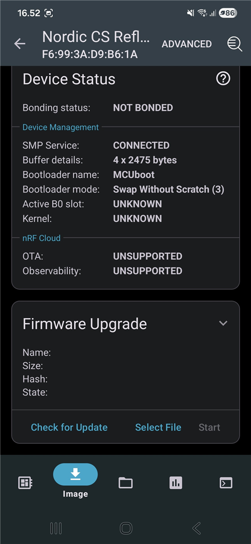

Open the nRF Connect Device Manager app and select Nordic CS Reflector to connect to the nRF54L15 Tag. Next, navigate to the Image section by tapping the arrow pointing downwards icon (the “download” symbol) at the bottom of the screen. Your app should now look as shown in the image below, and it should say SMP Service: CONNECTED.

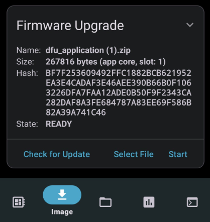

Press Select File in the Firmware Upgrade section and choose the dfu_application.zip file that you have sent to your phone. Once it is selected, you may start the OTA DFU by pressing Start.
Since the device already runs this firmware, the update process should detect this by comparing hashes and complete quickly, indicated by State: COMPLETED.
To test the OTA DFU further, you may compile the Peripheral LBS sample on your own using steps similar to those for the Channel Sounding Reflector, then update the nRF54L15 Tag’s firmware over the air to the Peripheral LBS sample.

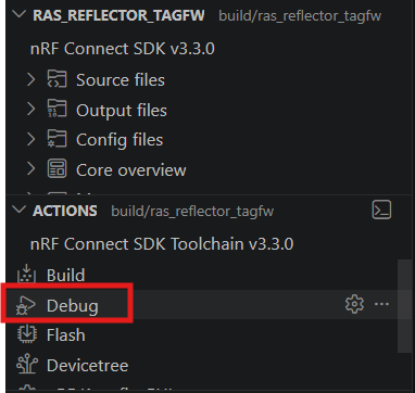

Debugging the nRF54L15 Tag is straightforward. Connect the tag to the DEBUG OUT header of an nRF54L or nRF91 Series development kit, then use the nRF Connect for VS Code extension to debug.
Connect the DK to your PC via USB-C and open the nRF Connect for VS Code extension. Select an application, choose the DK in the Connected Devices section, then click Debug to start debugging your nRF54L15 Tag.
Ensure that the tag is powered before doing this by following the instructions in the programming section.

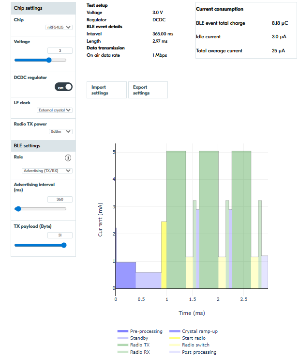

Next, we use the Nordic Online Power Profiler for Bluetooth LE to estimate average current consumption with various settings on the nRF54L15 SoC supplied with 3V voltage. Using Bluetooth LE connectable advertising (TX and RX) at 0 dBm TX power with a 0-byte TX payload yields the following values.
Advertising intervals for each target lifetime:
1 year (≈ 25 μA) → 200 ms
3 years (≈ 8.4 μA) → 840 ms
This means that with a CR2032 at full capacity powering the nRF54L15 Tag, you can do connectable advertising for 1 year with 200 ms advertising intervals and for 3 years with 840 ms advertising intervals on average. Pretty neat!
Increasing the TX payload to 31 Bytes, the values change as follows:
1 year → 360 ms
3 years → 1500 ms
Feel free to test out different settings and TX powers by yourself using the Online Power Profiler. It also supports calculating power consumption for Matter over Thread, which is supported by the nRF54L15 Tag.
