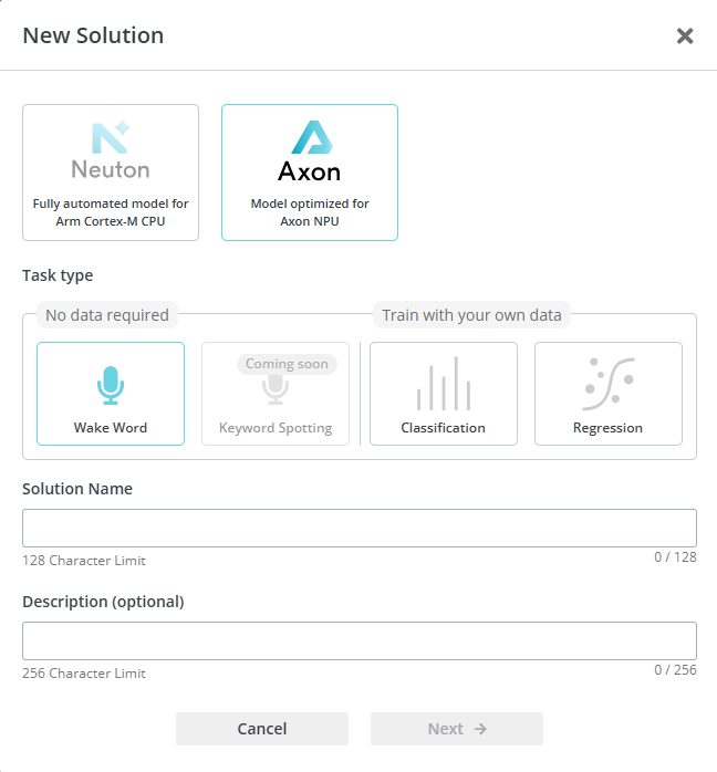

The Nordic Edge AI Lab adds two new features to support the Axon NPU, training classification or regression models based on your custom dataset, and using the automatic, no-data wake-word pipeline, dubbed “Text-to-wake-word”.

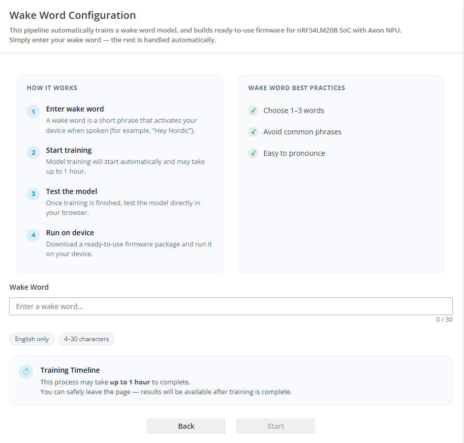

Text-to-wake-word
This feature generates wake‑word models from a single text input – such as “Okay Nordic” - removing the need to collect and label thousands of spoken samples. The Edge AI Lab automatically creates a classifier to recognize the wake word in audio, dramatically reducing data-collection time and enabling teams to evaluate voice triggers early. The resulting model can be built into nRF Connect SDK applications using the Edge AI Add-on and executed on any Axon NPU-enabled Nordic SoC, like the nRF54LM20B.

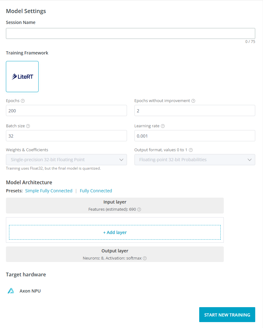

The Nordic Edge AI Lab now supports building LiteRT models for the Axon NPU, allowing you to upload your own dataset and specify the model architecture to generate classification or regression models, and then target and deploy them on the Axon NPU-integrated SoC. It complements the automated Neuton (CPU-run) flow by providing models compatible with running on the Axon NPU. On the nRF54LM20B, the integrated Axon NPU executes these TensorFlow Lite–class models with up to 15x faster inference than the CPU, making it ideal for high-rate sensor streams, audio, or imaging where throughput and efficiency matter.
The workflow of this is similar to what is offered for custom Neuton models, where the user uploads a custom dataset to create a model based on their use case for their application. The key difference is that after uploading the dataset, users must also specify an architecture before a training session can be completed.

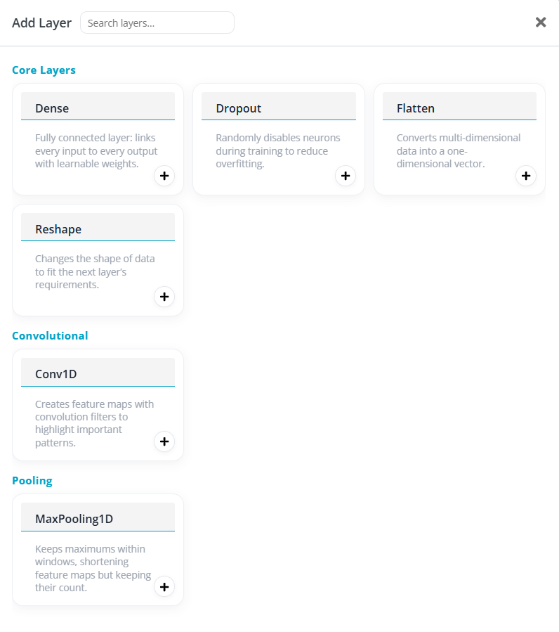

The main part of defining a neural network's architecture is specifying the number of layers and the content of each layer. There are two presets available: “Simple Fully Connected” consists of three dense layers with 64, 32 and 16 neurons, respectively. The “Fully Connected” preset includes three dense layers of 256, 128 and 64 neurons, and dropout layers with a rate of 0.2 after each layer of neurons. The advanced user can also opt to specify their own custom architecture, based on layer blocks, operations available as a part of the Axon NPU’s feature set.
After training has completed, the model is downloaded as a header file (.h) representing the model, compiled for inference on the Axon NPU. Running these models on the CPU is not possible.
