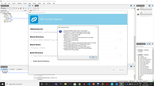

    I Made all changes but I am still getting the same error that I informed you of at the beginning. I have done the research for the error and that could be one possibility that space between my user name. which are not allowing segger to connect path. I tried to change the user name folder but I guess now I can not change the same. (suggest to me how to solve this problem).

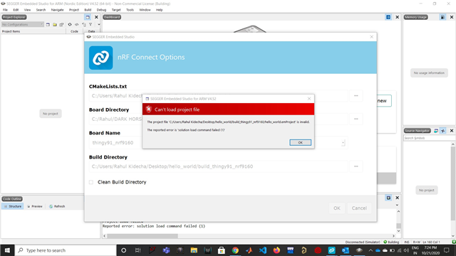

    To avoid the user name problem I used another PC and did the step shown in the tutorial. after setting the cmakelist.txt, Board directory, board name, and build directory when I click on the OK button segger was getting hang. (Tried 3 times and getting the same error)
    This is most likely correct! Changing the username and updating the path correctly can be a bit of a hassle, but Microsoft have described the approach here. Anyway, what kind of hang/error did you get on the other PC? Could you provide some screenshots/logs?

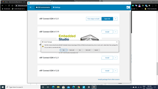

  • Hello Carl,
    Now to avoid all the problems what I have done is created a new account with just a name and tried to build and flash the hello program using j link Edu.
    we tried 1st time everything worked well but we were not able to see the output on the terminal. So we tried to flash it again but now, what is happening that when I open segger with toolchain manager software was getting hang not allowing to anything?
    Also showing below error everytime when I click on open IDE.
    Now when clicking on Yes to all or No to all. software is getting the hang (while j link Edu is connected)

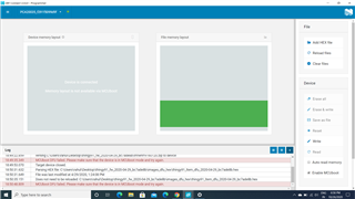

    Another thing is that now when I tried to load the pre-compiled Hex file it was not going under the MCU mode. (I know how to set in MCU mode)
    Questions:
    might be earlier we have done some mistake while flashing the hello program which led to any failure of the thingy:91?
    can we reset thingy 91 OR clear the flash memory?
