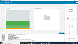

    When it comes to the Thingy:91 programming, it may be that the bootloader was overwritten (which is required for MCU Boot). Are you able to read the memory of the Thingy:91 in the nRF Connect programmer app when it's connected using the JLINK? If so, post a screenshot of it here.
    To reenable MCU Boot I recommend flashing one of the full images from the Thingy:91 firmware package, located on the product page.

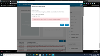

  • Hi Carl,
    I got your point regarding MCU boot mode. I did it earlier successfully but now when I tried to reload the modem firmware but every time showing the below error.
    But when I tried to set nRF52840 into MCU boot mode it goes under boot mode but nRF9160 did not.

  • I see.
    What kind of errors did you experience when trying to flash hello_world with the JLink EDU? Did you try to do it using the nRF Connect Programmer app? The IC is probably not damaged, but as mentioned the bootloader may have been erased (which is why MCUBoot won't work).
    If the bootloader is erased the only way to restore the device is using a debugger, like the JLink Edu. The debugger can also be used to flash the modem file.
    What are you seeing in the nRF Connect programmer app when connected through the JLink Edu? Please provide a screenshot.

  • What are you seeing in the nRF Connect programmer app when connected through the JLink Edu? Please provide a screenshot.
    check below Image
