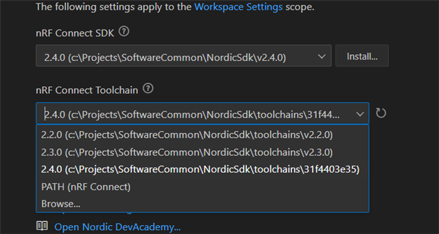

  • Hello, thanks for the reply,
    Yes, I am using version 2.4.0 of the SDK. I moved the install to a different directory but it is an install from the nRF Connect application, automatic install. My zephyr-sdk is version 0.16.0
