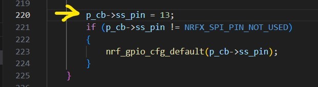

  • Hi Paolo,
    Is there anything on your board that can account for the added current consumption?
    If there is, have you tried to isolate the nRF only to see if this lowers the current?
    Depending on the type of ext flash you're using, 30 uA can potentially be the stand-by current consumption of that IC.
    Håkon
  • Hi Hakon,
    Yes, there is an external SPI flash but I assume that when all related I/O pins are set to HI-Z it shouldn't be backdriven, anyway just to try I've uncommented the line below for &spi0 and &spi1:
    And magically the extra-current disappeared !!!! How do you explain this?
    thank you, Paolo

    Such example turns ON the sensor, then successfuly reads its ID, then turns OFF the sensor in an infinite loop. Unfortunately the sensor doesn't turn OFF because of back-driving from CSN pin, indeed I realized that the call to:
       pm_device_action_run(mems_spi_dev, PM_DEVICE_ACTION_SUSPEND);
    doesn't handle CSN pin because the field that should contain its value reports 255 (NRFX_SPI_PIN_NOT_USED).
    CLK, MISO and MOSI are handled correctly, instead.
    As a proof and just to test, if I modified the zephyr original source code in "nrfx_spi.c" as follows and at last the sensor turned OFF successfully.
    Can you please help me on this ?
    The CSN must be initially configured as the sensor ID is read successfully, so what am I missing ?
    thank you very much in advance, Paolo
