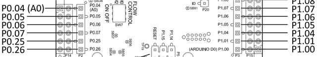

  • I do not have an overlay file. Is that required for this case? I got the pin numbers from the file "C:\ncs\v2.4.0\zephyr\boards\arm\nrf5340dk_nrf5340\nrf5340_cpuapp_common.dts", I thought that might be all that was necessary. I use pin p1.14 for _pin_clk and p1.12 for _pin_din. That should correspond to 18 and 16 respectively.
    Further, what do you mean by "compiled DTS", where do I find that?
    When using the logic analyzer, I have both measured with the mic connected and directly at the board pin(p1.14), but no clock signal is detected either way. So the problem seems to be on the board.

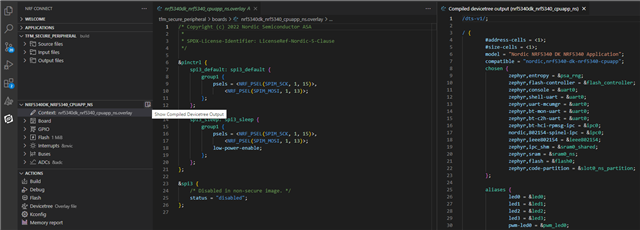

    Device Tree Structure information is represented in .DTS files. Zephyr.DTS file is the compiled output file that uses board.dts (specific board information) and board.overlay (user specific overlay files) along with bindings information. The <devicetree.h> header file provides the mechanism to access device nodes from the DTS. This describes the said procedure used in zephyr.
    When ever you want/need to configure your hardware, you do it using the overlay files. An example of overlay file, how to see the compiled DTS, and the zephyr compiled DTS are shown in example project below.
    I think you got it wrong. The Arduino header (analog and digital pins) are connected to the gpio0 and gpio1 pins on the DK.

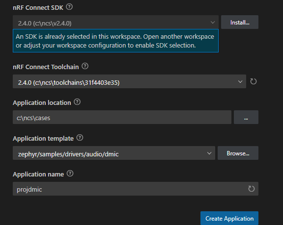

    I suggest you to start looking at DMIC project
    Then compile it for nrf5340dk_nrf5340_cpuapp.
    Have a look at /boards/nrf5340dk_nrf5340_cpuapp.overlay file
    and also at the compiled DTS.
    You would see that the PDM is configured as below
    Clock Port0 pin25
    Datain Port0 pin26
    (you could definitely change the pins and other configurations, but make sure there are no conflicts, and all the requirements are met etc.)
