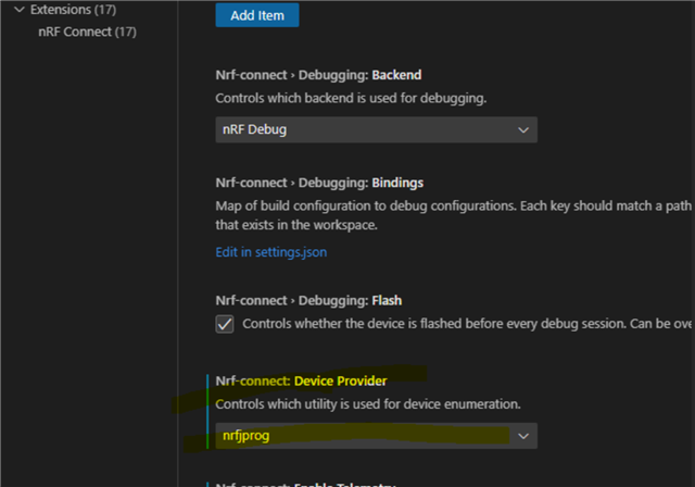

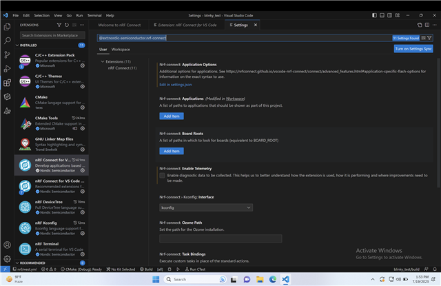

Hi Priyanka,
Thanks for your suggestion. But I couldn't find the same settings under nrf connect for VScode extension settings, as you can see below.
Did you select the extension settings here:
-Priyanka
yes I have tried both ways. first I tried by right clicking it then selecting the settings logo.

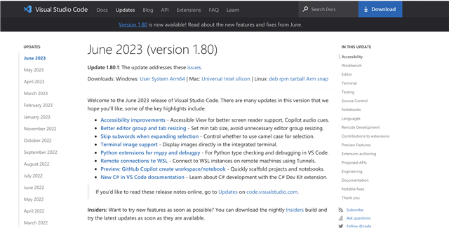

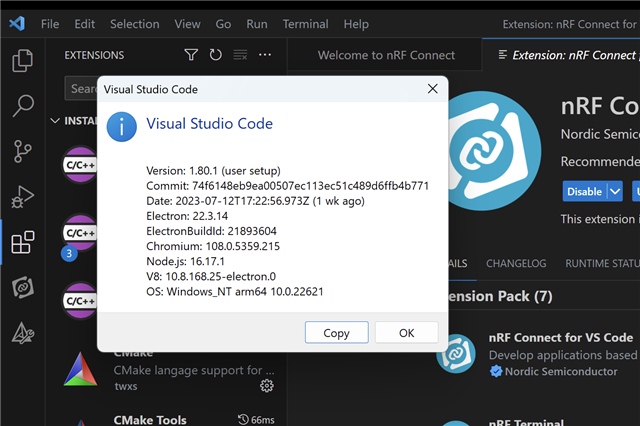

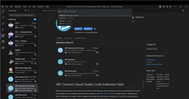

Your nRF Connect for VSCode extension is quite old. Please upgrade it to the latest version 223.6.345. But first you will have to upgrade your VSCode version too, to v1.74.0 or something newer.
-Priyanka

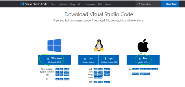

ok understood. can you please tell which version would be preferable for my machine, User , System or ARM64 ? I am running windows 11 on parallels desktop app on MacBook Pro M2 Pro.
It's always recommended to download the latest versions of everything. You can just click on the symbol for download.
-Priyanka
That is where I downloaded from earlier. As you can see in the screenshot below, my vscode is updated to its latest version. The latest version of nRF vscode extension pack is showing 2023.6.6
