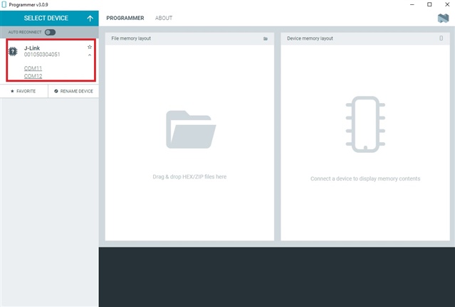

I see two associated COM ports on my computer:

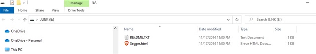

It also opens up an MSD File Explorer window:

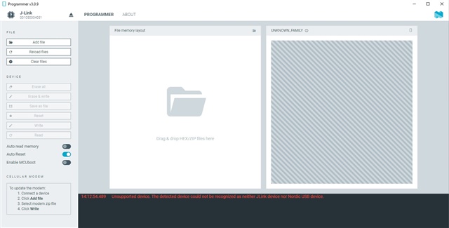

Within the programmer I see the following:
When I select J-Link I see Unsupported device. The detected device could not be recognized as neither JLink device nor Nordic USB device.

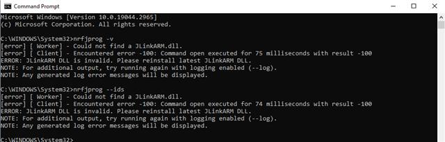

    Have you installed nRF Command Line tools?
    Can you use that and run:
    nrfjprog -v
    What does it return?
    Can you also do:
    nrfjprog --ids

    nrfjprog -v give me the following:
    nrfjprog --ids gives me the following:

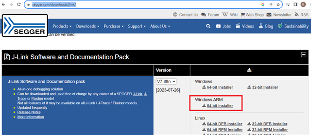

    So, I missed a step somewhere and did not install J-Link. I found the following link:
    https://www.segger.com/downloads/jlink/
    I assume based on the error I would need to use the Windows ARM installer?

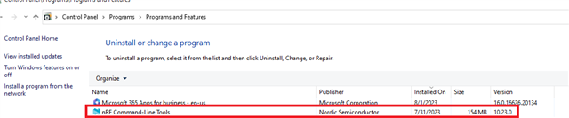

  • Thanks for the response Jared.
    I had installed the nRF Command Line Tools as I described above from this link:
    nRF Command Line Tools - Downloads - nordicsemi.com
    Again, when I type the commands that you mention I get the following errors:
    You mention above - "What you want is to download nRF Command Line Tools that includes J-link and other SEGGER sw needed to program our devkits and ICs, you can download it here,"
    but I do not see a link to download??
    Is the link I downloaded and installed the tools the correct link?
    If so, can you help me understand why I am getting the errors and what I need to do to resolve them?

  • Hi Brent,
    I'm very sorry that I missed that part, but that was exactly the link that I tried to share. Have you tried to reinstall it as suggested by the error message?
    Also, the error message suggest that you run the command again with the --log argument appended, so like this:
    nrfjprog -h --log
    that will reproduce a log that is more verbose. Can you upload that log here? Just drag and drop the file into the reply box,

  • Hi Jared,
    I uninstalled the command line tools and installed them as an administrator. That seems to have fixed the issue.
    Thank you for your help.
