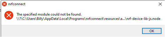

New install. Get error below when opening Power Profiler.
Hey same error here.
nrf Connect for Desktop Version: 4.2.1
The error can be ssen when starting Direct Teset Mode v2.1.0 & Toolchainmanager v1.2.5.
Freshly installed multiple times.
PC ist Windows10 Pro Version 22H2 (newly installed two times).
Intel i5-8350U 24 GB RAM 240 GB SSD.

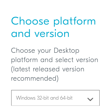

Older versions are available if you choose "Windows 32-bit and 64-bit" as a platform in the drop-down menu on the left.
