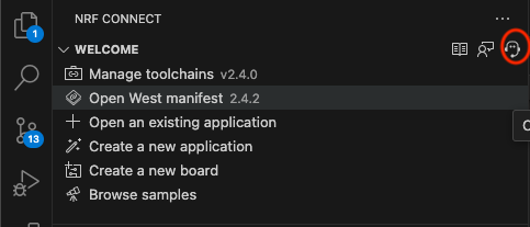

    It should work out of the box if everything is set up correctly (which should be handled automatically by the toolchain manager), so this could be linked to the toolchain issues it seems you are seeing for some reason. But it could be interesting if you can check which device provider you have selected as shown in this post? If you have the latest versions of the tools, you should normally select "nrfutil", but it would be interesting to know if either of the options work in your case.
  • But it could be interesting if you can check which device provider you have selected as shown in this post? If you have the latest versions of the tools, you should normally select "nrfutil", but it would be interesting to know if either of the options work in your case.
    Bingo..... the Device Provider had defaulted to "nrfutil" !!!.... when I changed to "nrfjprog" (that is the second selection in its dropdown list) and refreshed the VB's connected devices ......the PDA10056 signed in and is detected correctly.
    I was expecting the PDA10059 dongle to show up there also, alas it is not, should it appear there? or do I have to drop hex files and soft devices to it using the NRF Connect Programmer.
    Thanks for confirming that switching to nrfjprog helps. Does nrfutil work if you download nrfutil from here, add it in your path and install the device command as explained on the download page?
    Regarding the nRF52840 dongle (pca10059), that will not show up as it does not have an onboard debugger. So you need to use nRf Command Programmer, which will program it via USB DFU.

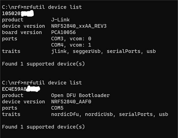

    Edit: I confirmed that nrfutil is bundled with the VS Code plugin, but it would be good if you could get the stand-alone version and try "nrfutil device list" to see if it lists you DK? Also, can you generate the support information by clicking here and share that?
  • It does manually install ok .... and path set to find it in system variables, however VB code does not pick up the nrfutil utility.
    Command line does find both the PCA10056 and PCA10059
